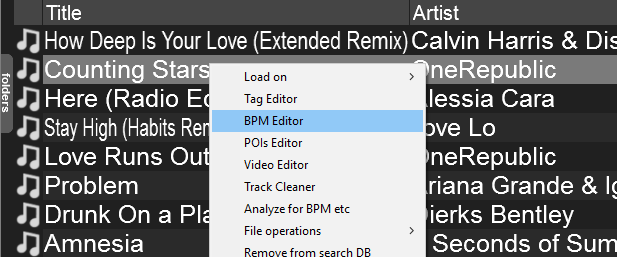

The BPM Editor can be accessed by clicking on the cover art in the Track Info Display or by right-clicking on a track in the File List of the browser.
