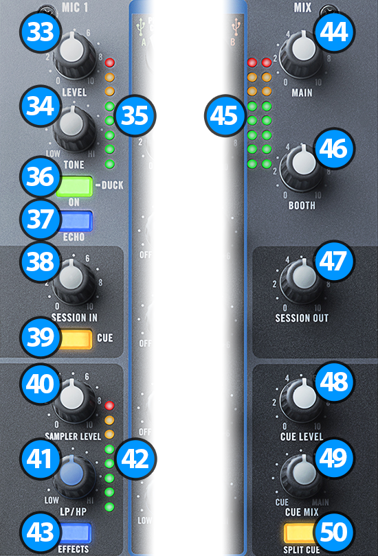

Input/Output Controls
KEY
ACTION
33 MIC 1 VOLUME
Adjust the volume of the microphone 1 input (located on the rear side of the device)
34 MIC 1TONE
Adjust the tone (single band equalizer) of the microphone 1 input.
35 MIC 1 VUMETER
Shows the incoming signal level of microphone 1 input.
36 MIC 1 DUCK
Enables ducking (also knows as talk over) for microphone 1 input.
When Duck is active, the volume of mixer channels is automatically lowered when the microphone receives signal.
37 MIC 1 ECHO
Applies an Echo effect on microphone 1 input
38 SESSION IN
Adjusts the volume of the incoming signal on "Session" input on the rear of the device.
39 SESSION IN CUE (PFL)
Sends the signal of the "Session" input on the headphones channel for pre-listening.
40 SAMPLER VOLUME
Adjusts the volume of the Sampler.
41 SAMPLER HP/LP FILTER
Applies a High-pass/Low-pass resonance filter on the output of the sampler. Middle position is OFF position (no filter applied).
42 SAMPLER VUMETER
Shows the incoming signal level of the sampler.
43 SAMPLER FLEX FX
Sends the sampler output to the unit's FLEX FX effects.
44 MASTER VOLUME
Adjusts the volume of the master output of the device.
45 MASTER VUMETER
Shows the strength of the signal on the master output.
46 BOOTH VOLUME
Adjusts the volume of the booth output of the device.
47 SESSION OUT VOLUME
Adjusts the volume of the "Session" output of the device.
48 HEADPHONES VOLUME
Adjusts the volume of the headphones channel.
49 HEADPHONES MIXING
Blends the audio that's being sent on the headphones channel between the headphones signal (far left) and the master output signal (far right).
50 HEADPHONES SPLIT
Splits the audio that's being sent on the headphones to headphones signal (left channel) and master output signal (right channel).
