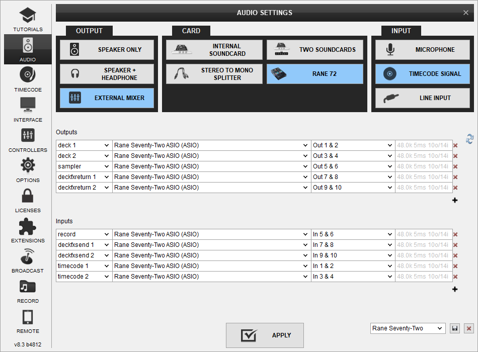

  • Open VirtualDJ configuration window and select the AUDIO tab on the left
  • Click on the "TIMECODE SIGNAL" button to enable the timecode inputs
  • Your sound setup should be like the one shown on the following image:
    Rane Seventy Two Sound Configuration with Timecode Inputs Configured
  • Click on "Apply" button
