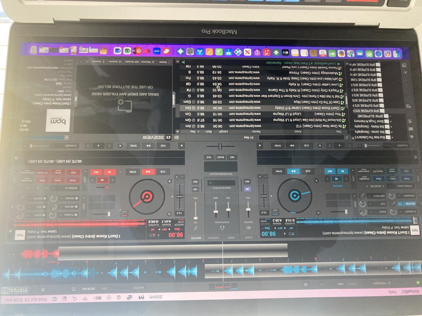

So If I hit Loop and start Track at the same time...That Loop is Greyed out...The track will run and the portion of the Loop in this case 4 beats IS looping but it is not playing any sound ? The sound begins after the set loop. I can set a loop anywhere else except the very 1st beat. It is not that big a Deal I can work around it..Just found it odd thats all...I took a picture of it but not sure how to post it here ? I just noticed it says "MUTE IN USE" ?
Posted Wed 12 Apr 23 @ 2:26 pm
1) Make sure that loopBackMode is set to "no" and try again.
2)"MUTE IN USE" should appear when the USB selector for that side of the controller is set to another USB port than the one you have your laptop connected to.
So, effectively you have set it to USB B while your laptop is connected on USB A, or the exact opposite
Posted Wed 12 Apr 23 @ 3:37 pm
