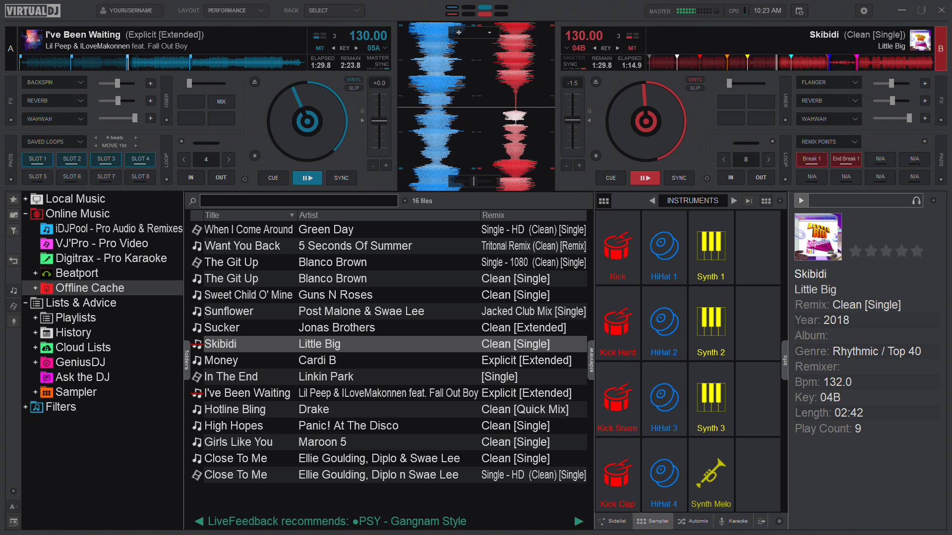

					layout

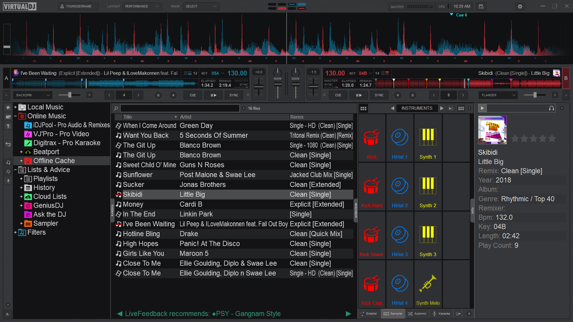

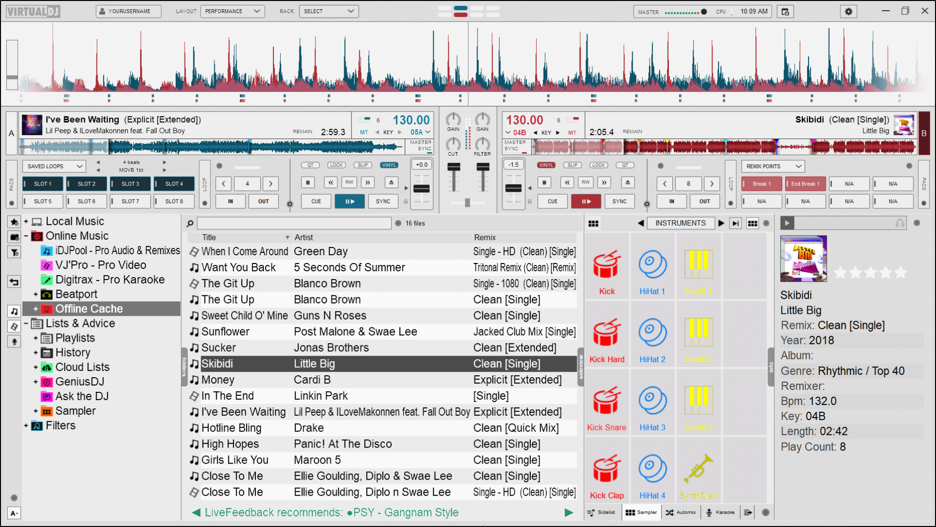

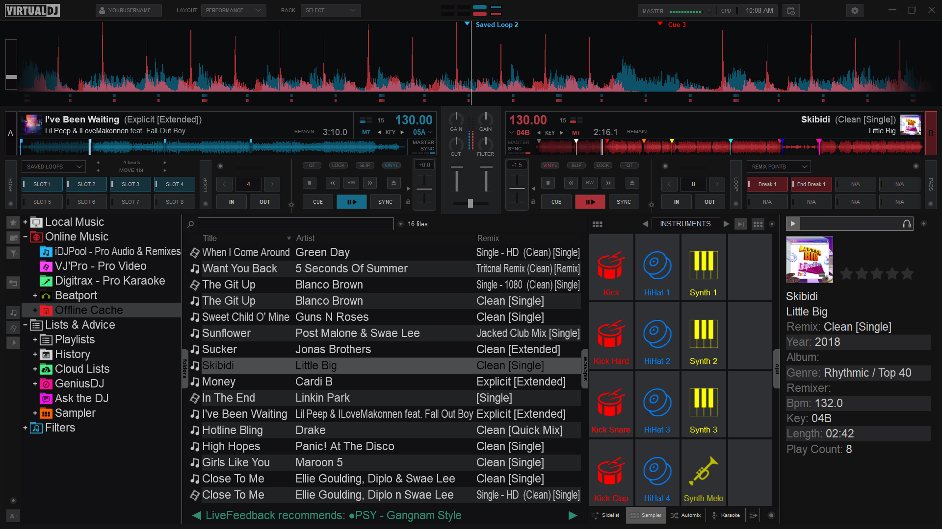

 The Layout menu provides the ability to change the overall look and feel of the Graphical User Interface (GUI). Depending on the Skin Layout that is chosen, other options become available to further customize the details of different areas such as the waveform and jog wheels. The Starter Layout has no customization ability, while Essentials and Pro Layouts have different Layout Options.
Color SchemeChanges the overall color of the layout (or skin). 3 options are available; Default, Contrast, or Daylight.

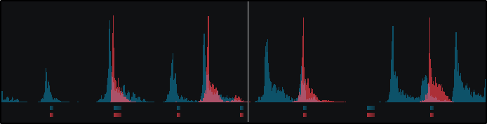

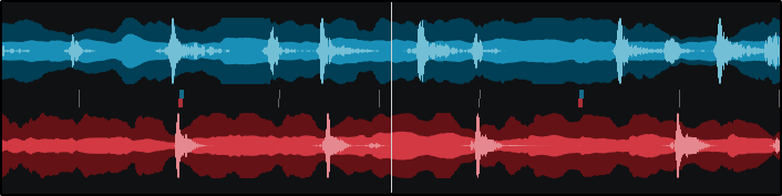

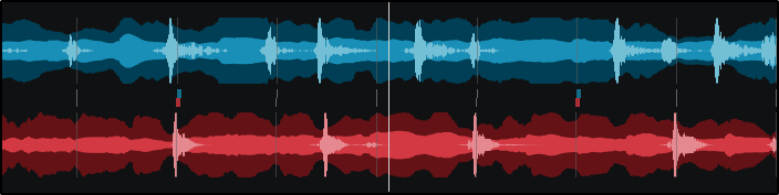

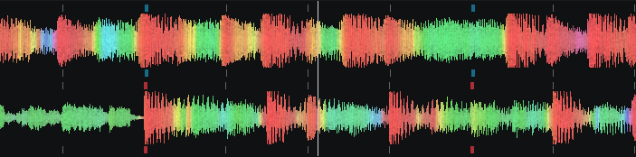

   Default  Contrast  Daylight Waveform DisplayChanges the appearance of the Rhythm Wave. 3 display options are available; Beats, Colors, or Shapes. An additional option to Show Gridlines on any of those options is also available at the bottom of the menu.
 Beats  Colors  Shapes  Show Gridlines

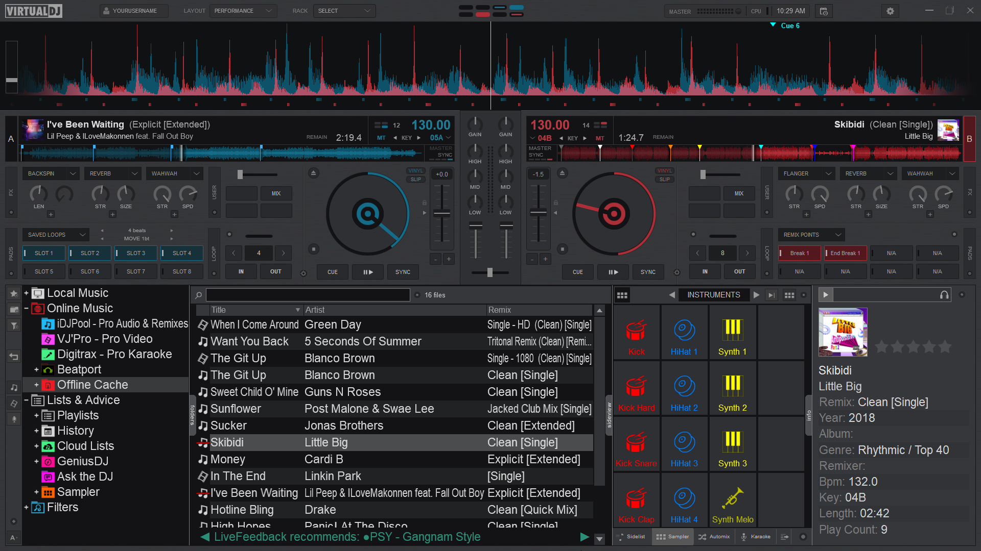

Jogwheel DisplayChanges the look of the jogwheel. 2 options are available; Turntable Look(default) and Spinner Look. Additional options for cover art display are also given for each look; None, Small, or Large(default).
   Turntable Look w/Large Cover Art  Spinner Look w/Large Cover Art  Turntable Look w/No Cover Art  Spinner Look w/Small Cover Art Color SchemeChanges the overall color of the layout (or skin). 4 options are available; Default, Contrast, Dark Mode, or Daylight.
   Default  Contrast
  Default  Contrast

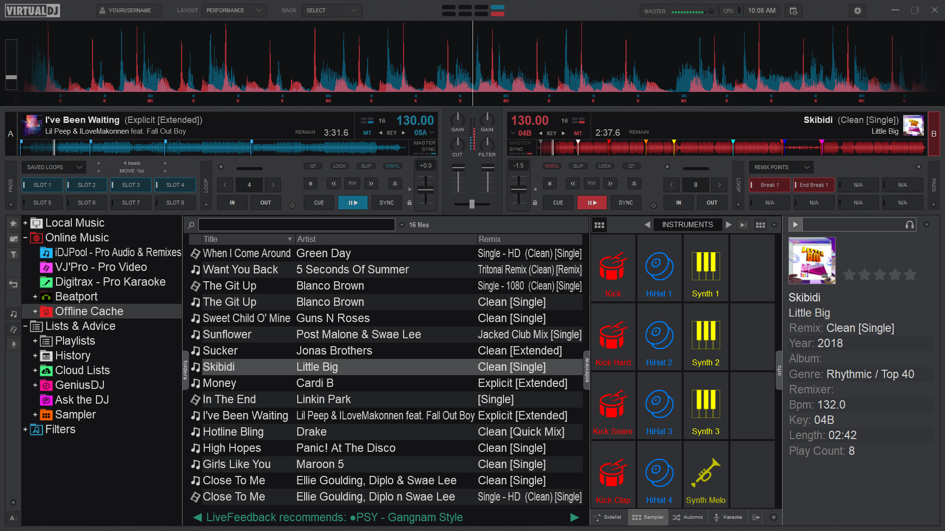

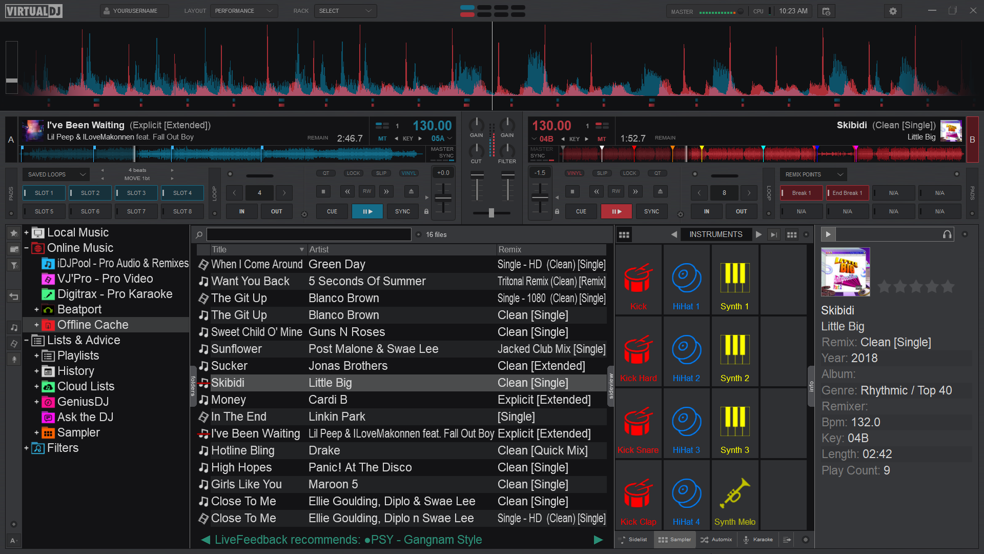

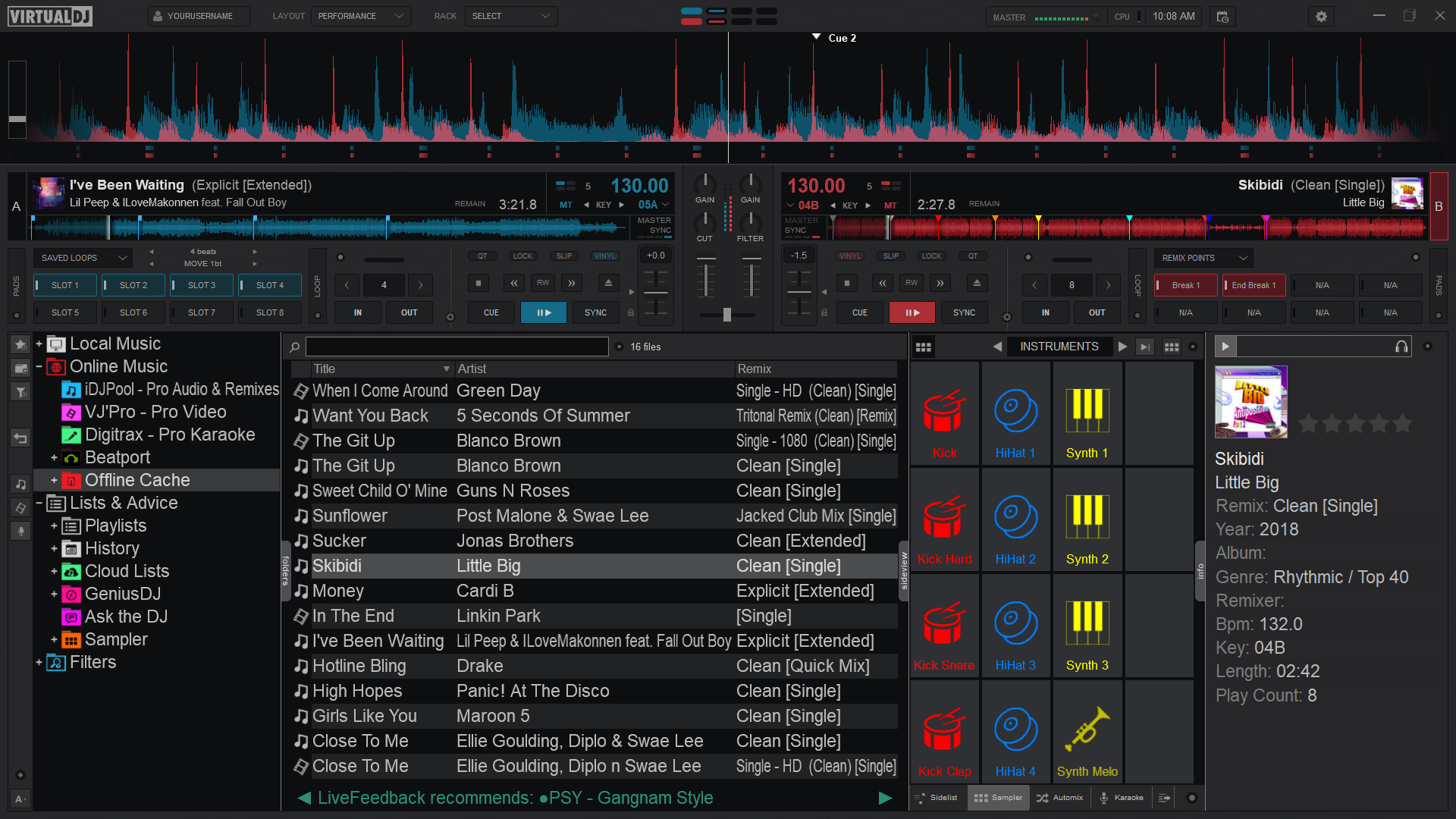

 Dark Mode  Daylight Waveform DisplayChanges the appearance of the Rhythm Wave. 3 appearance options, 3 color options, 2 position options, as well as the ability to show grid lines on the wave and display a bar counter on the waveform: appearance options
   Rhythm Enhanced (default)  Rhythm Mirrored  Full Spectrum
  Rhythm Enhanced (default)  Rhythm Mirrored  Full Spectrum  color options
   Monochrome (default)  Full Spectrum  Multi Color
  Monochrome (default)  Full Spectrum  Multi Color  position options
   Above  Below
  Above  Below  grid lines and bar counter
 Rhythm Enhanced Waveform w/Grid Lines and Bar Counter Jogwheel DisplayChanges the look of the jogwheel. 3 options are available; Needle, Text, or Needle + Text. The Needle look (default) displays just a spinner while the Text look will display deck information such as BPM, Pitch values as well as elapsed and remaining time. Choosing Needle + Text will combine the 2 looks together.
   Needle  Text  Needle + Text Beat CounterChanges the way Phrases are displayed. If Phrase Bars is selected, the phrase will be displayed inside the Beat Keeper with smaller dashes inside the main display. If Phrase Circles is selected, the phrase will be displayed on the outside of the Beat Keeper in a circular display. Selecting Show on Waveform will display the phrase position in text on the waveform.
 Phrase Bars  Phrase Circles 4-DecksDisplays 4-Deck Mode. Once selected additional display options are available. The default display is 4-Deck with a 2+2 Channel Mixer but can be changed to a full 4-Channel Mixer.
   4-Decks w/2+2 Channel Mixer  4-Decks w/4 Channel Mixer Color SchemeChanges the overall color of the layout (or skin). 4 options are available; Default, Contrast, Dark Mode, or Daylight.
   Default  Contrast
  Default  Contrast

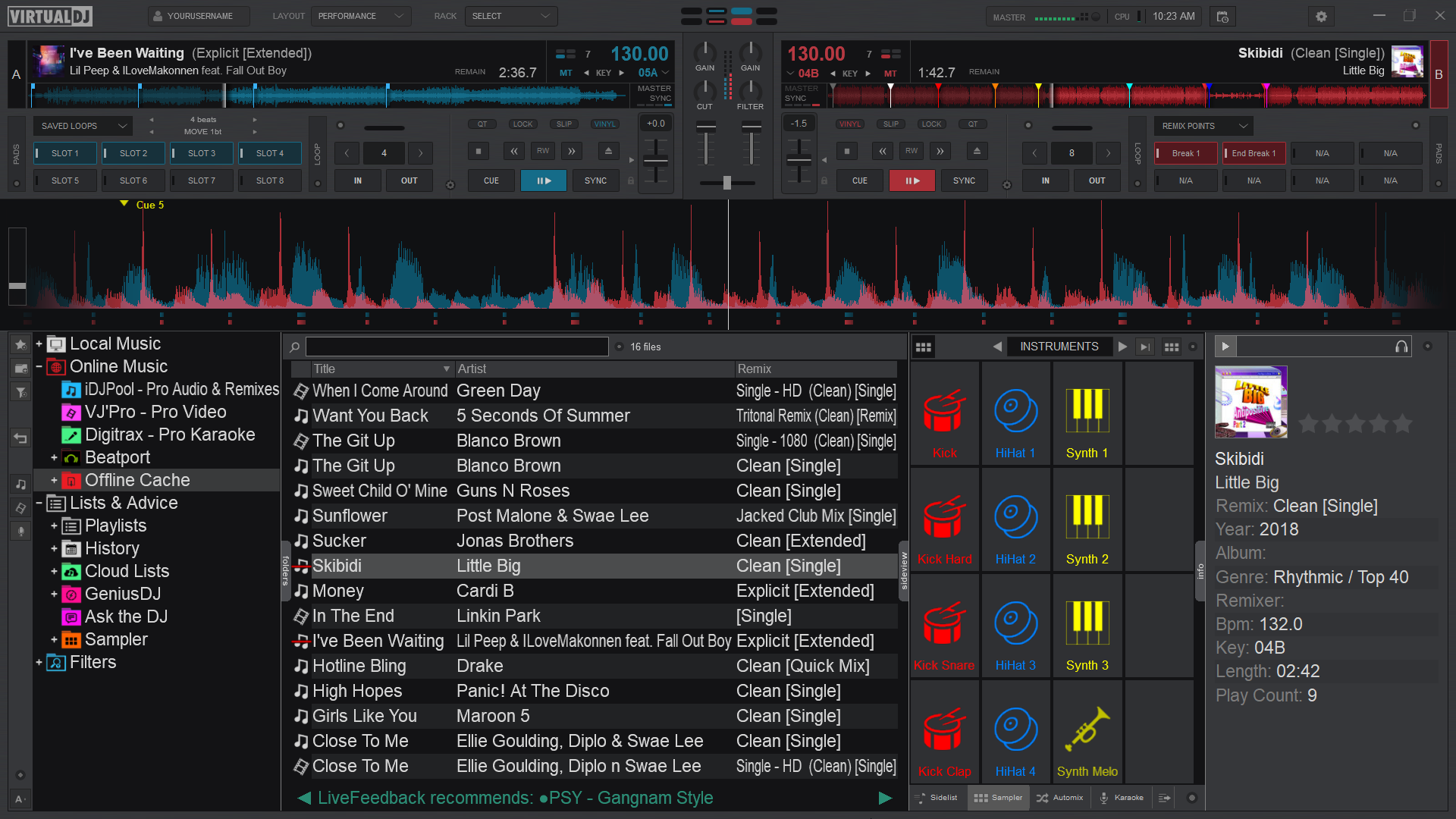

 Dark Mode  Daylight Waveform DisplayChanges the appearance of the Rhythm Wave. 3 appearance options, 3 color options, 3 position options, as well as the ability to show grid lines on the wave and display a bar counter on the waveform: appearance options
   Above  Below  Vertical
  Above  Below  Vertical  grid lines and bar counter
 Rhythm Enhanced Waveform w/Grid Lines and Bar Counter Deck LayoutChanges the size and position of the decks. 3 Options are available; Full, Compact (default) and Small. When the Full option is selected, other characteristics of the layout can be changed such as the jogwheels (See Pro Layout).
   Full  Compact (default)  Small 					Waveform Display
