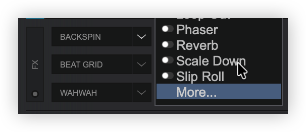

The Essentials Layout offers a Single FX panel. In this view, a single effect slot is offered with 2 parameter dials and a button to open the effect’s Graphical User Interface in the SideView area of the browser.
Clicking on the effect name will trigger the desired effect, while clicking the dropdown arrow will open the FX menu providing the ability to select one of the many other effects available.

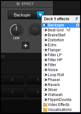

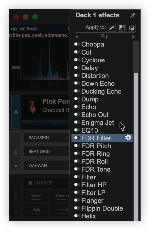

Once the Effect select button is pressed, an Effects Selection list will be displayed to easily scroll through all the available Sound and Video Effects to make your selection. The Sound Effects Group is displayed by default, and the Video Effects Groups will be nested as a separate folder. Clicking the Video Effects folder will open it and display those effects.
Click on the Pin icon to the right of Sound Effects to keep the Effect Selection list visible (pinned) after effect selection if required.
Once the Effect is selected it can be activated by clicking on the effect name in the Deck Effect Panel or in the Effect Selection List by clicking on the Activate Button to the left of the desired effect.
Multiple effects can be triggered from the Effect Selection list simultaneously regardless of the number of Effects visible in the Deck Effect Panel.

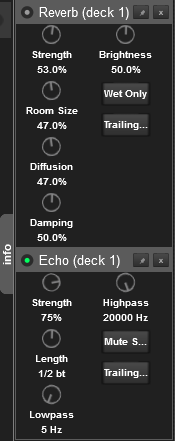

Clicking on the button in the Deck Effect Panel (if available) or the gear icon to the right of each effect in the Effect Selection List will open the GUI for the desired Effect and dock it to the lower right of the software interface beside the Info Panel.
The Effect can then be unpinned by using the Pin icon on top of the Effect GUI so that it can be re-positioned to anywhere on the screen for greater customization and ease of use. Clicking on the X will close the Effect GUI regardless of it’s position but will not deactivate the effect.

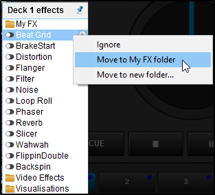

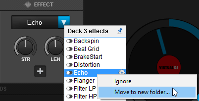

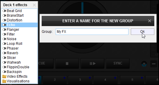

VirtualDJ offers the ability to group and organize the default, custom and VST effects. A new Effects Group can be created by right-clicking on any of the available Sound, Video or Visualization effects or folders and selecting Move to new folder...
Enter a name for the Effects Group and click OK.
Once the group is created, right-click on any additional effects and choose to move them to the newly created folder.
Additionally, effects can be set to Ignore if not being used. Clicking on Ignore will create a new Group (folder) and remove the selected effect from the main drop-down menu. All ignored effects will be placed into the ignore folder.

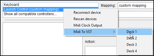

MIDI devices such as MIDI Keyboards can be set up to control VSTs through a deck. Right clicking the device in the Controller settings will bring up an option for MIDI to VST. You can then select which deck the VST will be controlled by the device when it is activated.
This setup is pass through. Mapping for the device is handled by the selected VST (if offered).
