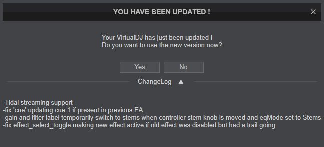

kradcliffe wrote :
Please stop resetting the skin, padding and auto pitch / BPM setings every time there's an major update.
We know the features are there so stop forcing them.
You could had downloaded separate to 2020 version
Posted Wed 05 Aug 20 @ 1:58 pm
There is only one settings file...
Posted Wed 05 Aug 20 @ 1:59 pm

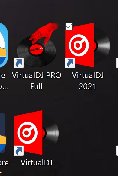

skatercorpse wrote :
Should I download it and install it to upgrade?
Is it going to overwrite the existing build already installed? Or will it be installed aside?
Download it as separate.
For some reason it ask me to upgrade I said no so I now have three versions on desktop
Posted Wed 05 Aug 20 @ 2:06 pm

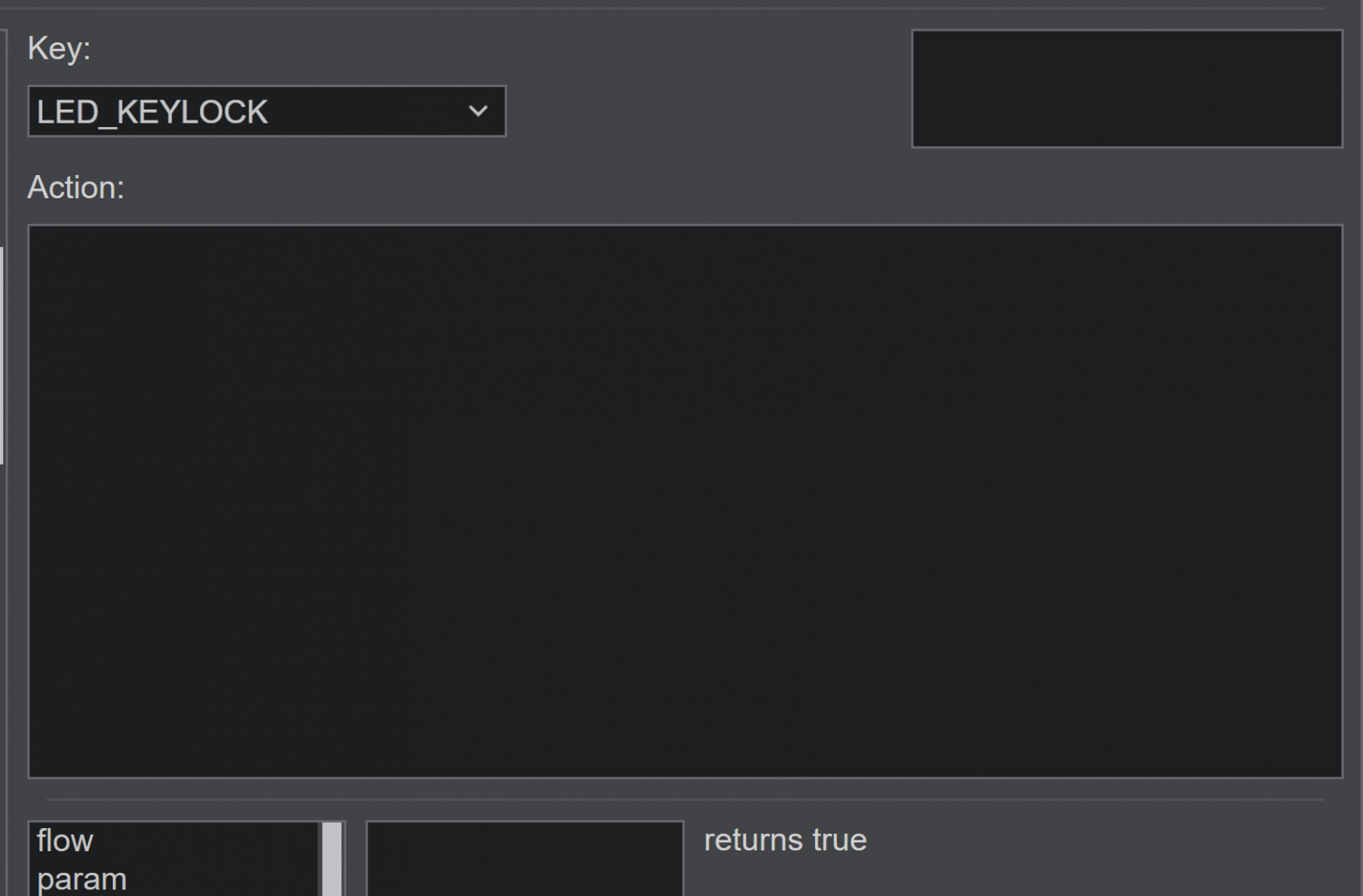

I previously wrote :
What would be the line for controller button mapping, to Toggle the Equalizers to Stems and back?"
The ans works prefectly
"eq_mode +1 "
What could I add to this line to toggle the Button's LED on and off ?
"eq_mode +1 "
Nicotux wrote :
"eq_mode +1 " only toggles Frequency (0) / EZRemix(1)
and does not report in EQ controls page
For button light on/off workaround is needed
For reporting in EQ controls page workaround is needed
NAME custom button `setting eqmode`
(with backquotes)
switch Frequency, EZRemix, ModernEQ, Stems :
on when EZRemix:
setting eqmode +1 & eq_mode
on when ModernEQ:
setting eqmode +2 & setting eqmode -1 && eq_mode
on when Stems:
setting eqmode +3 & setting eqmode -2 && eq_mode
on when not frequency:
setting eqmode frequency ? off & setting eqmode -1 & eq_mode : on & setting eqmode -1 & eq_mode
toggles between Frequency, EasyRemix:
on when EasyRemix
setting eqmode frequency ? off & eq_mode -1 : on & eq_mode -1
on when frequency
not setting eqmode frequency ? off & eq_mode -1 & eq_mode : on & eq_mode -1 & eq_mode
... ASO
(with backquotes)
on when EZRemix:
on when ModernEQ:
on when Stems:
on when EasyRemix
on when frequency
... ASO
Thank you so much for that amazing code, I come back to it once a day, hoping it will occur to how to implement it.
Which of those lines goes in the LED_KEYLOCK Action window in controllers mapping?
Again thank you for sharing your amazing insights and knowledge.
Posted Sat 08 Aug 20 @ 9:04 pm
