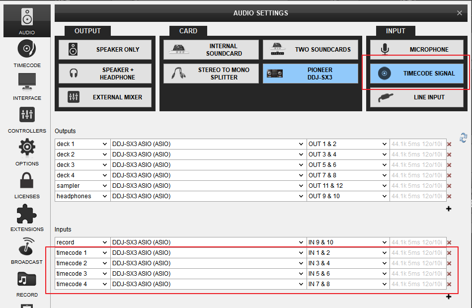

Open the AUDIO tab of VirtualDJ Settings and click on the TIMECODE SIGNAL button at the top-right, to automatically add the necessary timecode lines to the Audio setup. If line inputs are in the audio setup (offered by default), click on the LINE INPUT button as well, to remove the linein lines.
Click to APPLY.
VirtualDJ Timecode Audio Setup - Pioneer DDJ-SX3

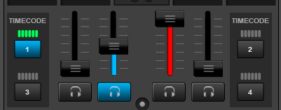

Use the TIMECODE ON buttons from the VDJ GUI to enable the Timecode controls to a VirtualDJ deck.
Timecode buttons - VirtualDJ Pro Default layout GUI
