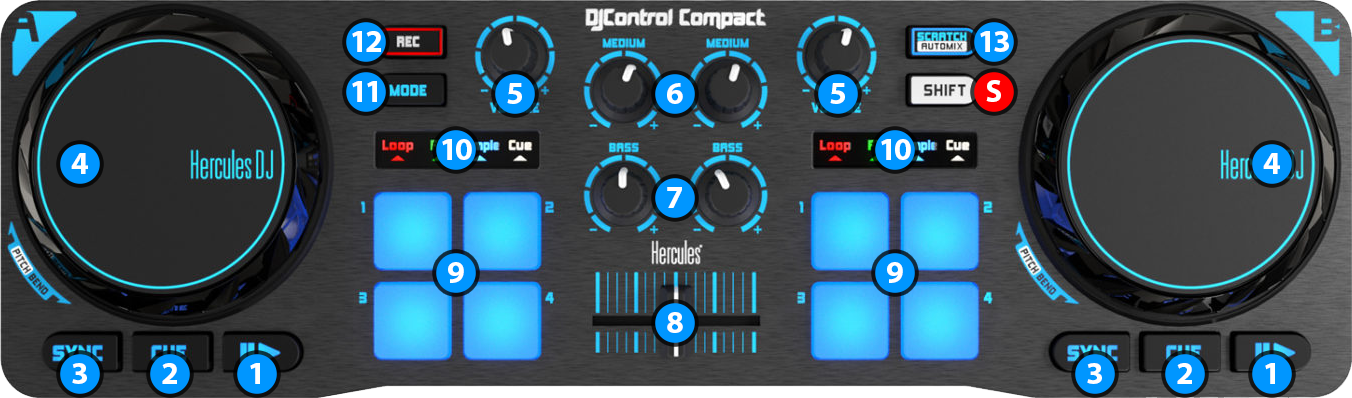

CONTROLS
S SHIFT
Press this button down to access secondary actions as described in the SHIFT ACTION column
KEY
ACTION
SHIFT (SECONDARY) ACTION
1 PLAY
Play/Pause the track loaded to left/right deck
Play-stutter track. When pressed, track will resume playing from the previously stopped position
2 CUE
Sets current position as Temporary Cue point.
Preview track when paused while button is pressed
Jumps and stops to the Cue point when playing[
Returns to the beginning of the track
3 SYNC
Match BPM and Beat Phase with the opposite deck
Smooth pitch reset. When pressed track will gradually get its original tempo
4 JOGWHEEL
Touch-sensitive jogwheel for scratching or bending (temporary speed up/down tempo) the track, depending on the Vinyl mode.
Adjust the tempo of the loaded track.
5 VOLUME
Adjust the volume of the left/right deck.
6 MEDIUM
Adjust the medium (middle) frequencies of the left/right deck.
7 BASS
Adjust the bass (low) frequencies of the left/right deck.
8 CROSSFADER
When on far left position, only sound from the left deck will be heard from the Master Output. When at far right position, only the sound of the right deck will be heard from the Master Output. In all other positions, the audio signals from left/right decks will be blend.
9 PADS
These buttons offer different functionality depending on the selected Pads mode See Pads page for further details.
10 PAD MODE LEDS
Display the active Pads mode for left/right deck. See Pads page for further details.
11 PAD MODE
Press this button and then one of the pads to change the Pads mode for left/right deck. See Pads page for further details.
12 REC
Press this button once to start recording your mix. Press once again to stop recording.
13 SCRATCH
Enable/disable Vinyl mode on both Left/Right Decks. When enabled, use the upper/top surface of the jogwheel to scratch and the outer to bend. When disabled, the entire surface (upper and outer) of the jogwheel will be used for bending.
Press this button once to start automatic mixing. Press this button again to stop it.
