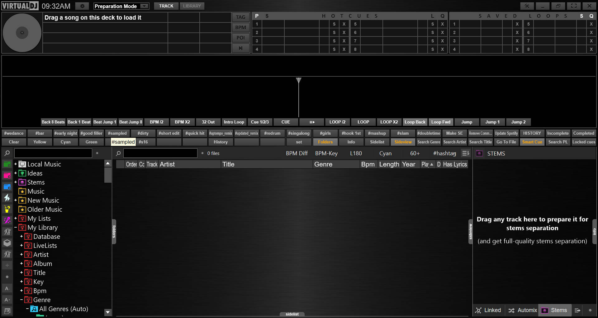

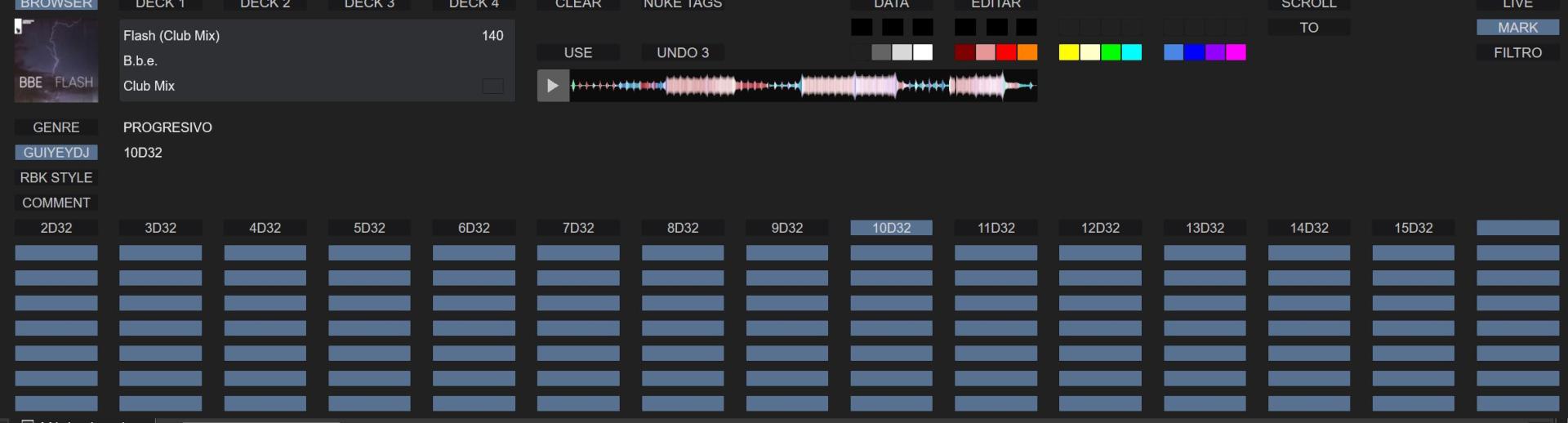

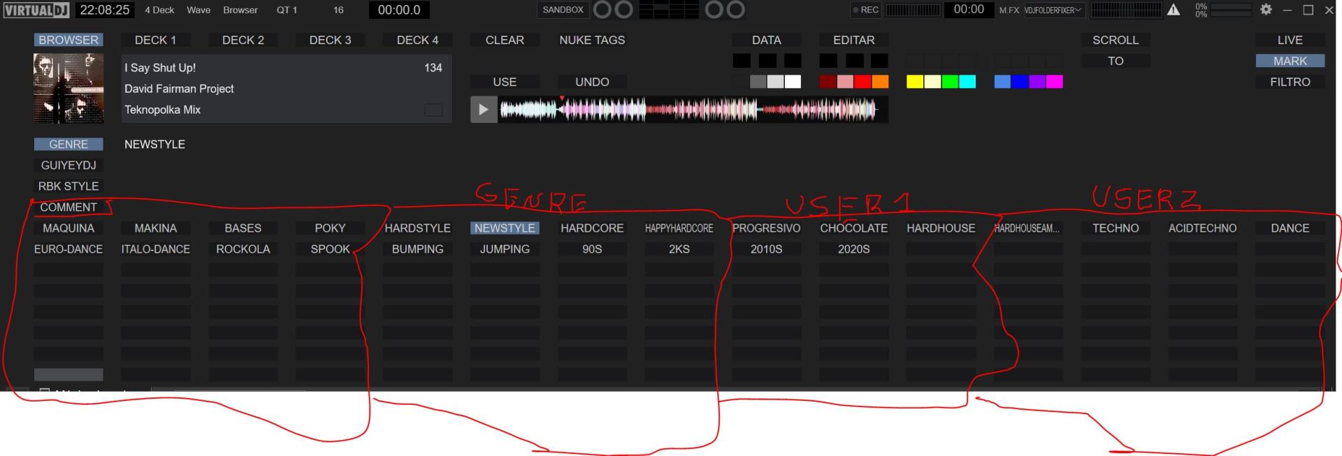

I edited the buttons of an old PhantomDJ prep skin (AI Helped) to make button. You can see in pic I used the top row for setting hot cues I use the most. What you doing now is similar but on major steroids. I like it.

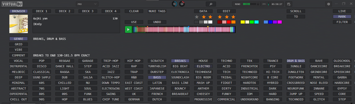

This is the main panel we'll go thru each element
top right corner,
live gets you back to decks
mark opens the marking panel [which we are looking at in the 1st pic]
filter opens the filter panel, which is discussed after
Top line left hand side
this is what source we will be marking
right click any of these and it will open the tag editor for that source
these buttons [excluding browser] are also drop zones, you can drag a track from the main browser or the album art on to a button and it will load on the corresponding deck
The 4 tag buttons
These are the tags we will be marking, your 2nd & 3rd will be named different but they are user1 & user2
left clicking selects the tag for writing
double click opens a popup that lets you type/edit the tag if there's something you want to manually type/delete
right clicking clears the tag [don't worry about fat finger]
Some of the main buttons from the grid of 120
right clicking will let you change what the button saves and writes
left clicking will write to tag, if you left click by mistake you can click again and it will be removed from the tag [this remove function has only a one press memory]
If the button is lit up it means the word is in the tag and can't be written again.
track data basics
artist, title remix, bpm, can't be edited, [just yet anyway]
the little square in the right corner is the track colour, clicking it opens a dialog box to manually enter a colour; default English like RED or you can use hex code #ff0000
this whole area is a dropzone to load a track to the corresponding deck
[if on browser it will load to deck 1]
rating & colour
furthest left star to give a zero rating
furthest left colour to remove colour
Addition; 8 custom colours, if undefined click to define, if defined right click to redefine, left click to use
Nuke tags, does just that, it completely erases genre, user1, user2, and comment
don't panic about it, there's protection for the clumsy I'll mention in a minute
Data & edit
kind of like a grab feature
click data and the text on the button will become a '?'
When it's a '?' clicking any of the 120 grid buttons or any of the 4 tag buttons
What was held by the button pressed gets grabbed
the text on the data button will change again
now the edit button will allow you to edit the grabbed text
Even with the data button displaying the word "DATA" you can click edit to create a string
USE will use what is held by the data button and write to tag, not used often but there for those 1 off cases
UNDO
The fat finger protection
any time you write/delete/edit/nuke a tag, the system will take a snapshot of all 4 tags [genre,user1,user2, comment] before the change is made
so long as you don't edit another file you can undo all changes [40 step memory seems enough]
Clear, you won't use this much, it clears the undo history and clears the DATA button
Scroll & To
'here be dragons'
scroll will take whatever is on DATA button and scroll down the browser writing to every track until it hits the bottom
To is there if you only want to scroll a few tracks like say you're in a 30 track folder and the first 15 you want to tag as techno
first you'd get the word "techno" on to the data button
then you'd go to the 15th tracks, click the TO button
then take the browser scroll to the top of the browser and press SCROLL
There is no clumsy insurance for the scroll button, you can press it again quickly to stop it but it marks tracks at 30/second so use caution with it.

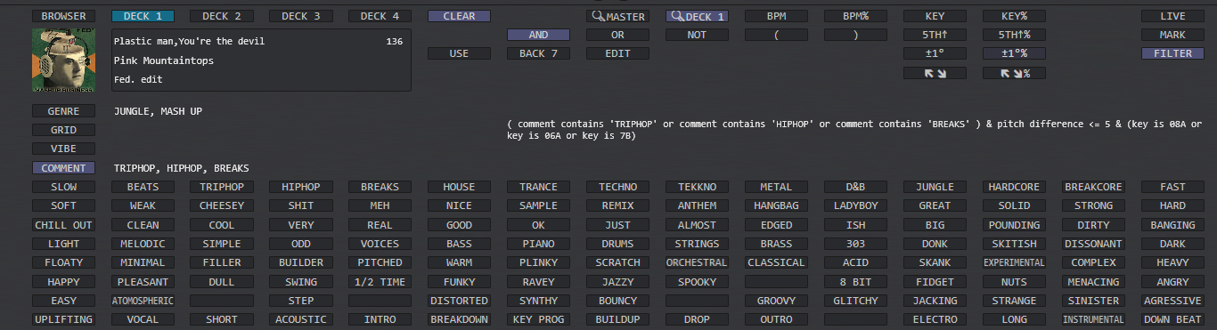

The filter page, not as serious as tagging but if you have done serious tagging then this will probably be useful
The logic buttons 'AND' 'OR' 'NOT'
One of AND OR should be lit up at all times, if they aren't click one [I'm not sure how that could happen, but it might.
with one of these on other button presses will work out
should I write ' & genre contains techno'
or should I write ' or genre contains techno'
the NOT button is an on/off switch to make the query negative
' & genre doesn't contain techno'
These two, on first start both will be off, only one can be on
when 'master' is on the 120 grid will light up any words that are found in the masterdeck [loudest deck] tag [whichever of the 4 tags we're focused on]
As you include these in your filter query the button lights will power down
handy to save you hunting for buttons.
the button that says 'deck 2' does the same thing but not masterdeck, but the deck designated as the source deck by the buttons above the track meta data mentioned at the start of this about filters
brackets, useful for combined filters
'genre contains house & ( genre contains handbag or genre contains vocal or genre contains soulful )
brackets keep a count of how many you have open, telling you how many you need to close to get a working filter
Buttons are smart enough to know,
if it should write ' & genre contains....' if in the middle of a set of queries.
or if it should write 'genre contains...' at the start of a query or next to an open bracket.
BPM will make you a filter of pitch difference <=5%
BPM% umm, I like to play tracks pitched, so a usual bpm filter would only really get me stuff that is a faster tempo but played nearer pitch neutral, not the vibe I want BPM% gets me pitch difference <=5% against absolute bpm then I can pitch up the new track just as much or close to it.
Whole lot of key filters
key direct key match
5th up a 5th +2 camelot users
1 degree +/-, basically adjacent on the camelot wheel 1a will return 12a, 2a & 1b
diagonal arrows, diagonal on the camelot wheel, 1a will return 12b & 2b
% variations, did I mention I like to play pitched up, same idea as bpm%
Star ratings because why not? not a rating user myself, context is too important to have just one measure of a track but it's there for those that do
Edit, you will have created a string and maybe there's something you want to manually type, maybe change an '&' to an 'or'
Use - actually use the filter you've created
it will type a * into search to get a database wide filter and apply the filter
you won't be able to use a filter if you have unclosed brackets [might auto close hanging brackets in next version]
BACK, again lovely fat finger protection, remembers upto 40 steps in creating your filter
this is a different memory to the marking memory
clear, like the clear in marking wipes the BACK memory and clears the string, also turns the filter off

Here is the text file for my tags.
I hope it works; let me know if anything needs changing.
I also wanted to ask if I need to modify a skin, or if using the custom buttons window found in some skins would suffice.
Thanks.
Thanks.

@GuiYeYDJ List is good
I'm in the process of adding little bits here and there also final in house testing.
I added 8 custom colour buttons now and added some things to make it even quicker [like point and click is ok but some stuff a keyboard shortcut would be even quicker]
And all the shortcuts are super simple script like to go back in marking history it's just
multibutton markundo
And I've made sure that everything it does has a simple script like this
As for what you need to do, it's almost nothing
If you could send me a link to your usual skin in PM [even if it's default], I will see how it fits
the only thing you will need to do is use a custom button once, with a script I give you, that will put your list on the buttons [and then you can; change them / add to them /reorder them, after that]

hi, thanks i´m testing it, found a bug or maybe isn´t, sure you are adviced:
in some cases when i select a tag in my case 10d32 all empty buttons get colored like they been selected,
thanks for hard work!!
i forget ask for use for DATA button, CLEAR aparently do nothing and NUKE delete all tags, maybe Clear must delete only feature who is located now...example if i was in genre only delete all genres from this track...
thanks again
thanks again

I'll check that, might be because tag contains zero
I'll test and think of a fix
