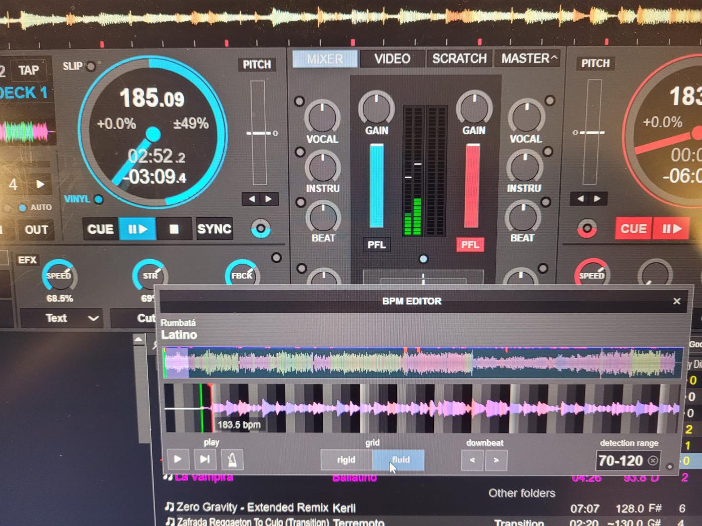

slight issue here, fluid range is set to 70-120 but song still is up at 180, 190
Posted Fri 03 Apr 26 @ 6:57 pm
Comes in at 91.76 for me (range 60-180). What build are you on?
It does get a bit confused in places though.
Posted Fri 03 Apr 26 @ 7:02 pm
did you rescan?
nevermind, i just had to reanalize it. it was previously analized without the limit
I thought just flicking back and forth between fluid would do it.
thanks
