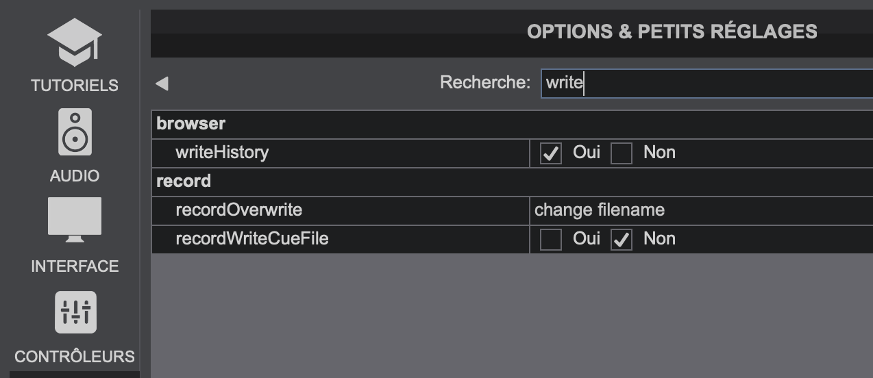

setting writeHistory
for practice sessions you could turn that off

sure the first is a setting, just go into options and type "write"

I'm still confused.
"sure the first is a setting, just go into options and type "write""
I've just typed "write". That's it for the first step ? I don't change any setting or parameter ?
Posted Wed 18 Mar 26 @ 11:09 am
oui - it will write history /last played
non - it won't.
non - it won't.
Posted Wed 18 Mar 26 @ 11:55 am

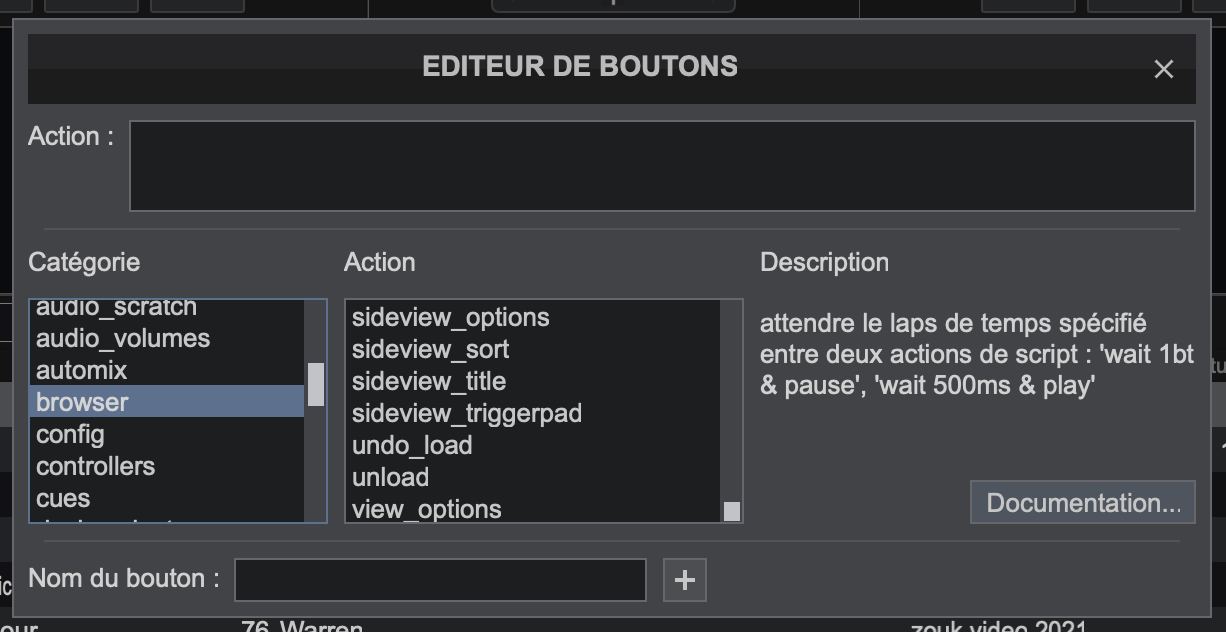

Alright i get it. I was confused by the code lines.
Now is it me or no Custom button can be used for this action ?
Posted Wed 18 Mar 26 @ 9:47 pm
Just enter
The button will switch writeHistory on/off and change the button colour too.
setting "writeHistory"to the Action: area
Posted Wed 18 Mar 26 @ 10:03 pm
