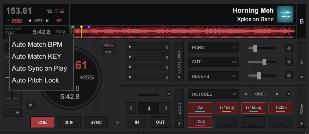

Auto sync or bpm match in settings
And make sure the tempo range is high
50% or 100%
Bpm will match on song load
50% or 100%
Posted Sun 22 Feb 26 @ 12:12 pm
50% or 100%
50% or 100%
You got the answer here.
Read up on the auto sync options here.
Posted Sun 22 Feb 26 @ 12:42 pm

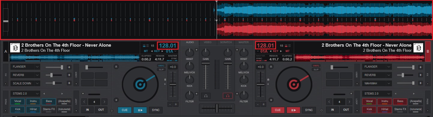

Thank you for your answer - unfortunately I still don't know the answer to my question. Another issue is that even if you set the BPM of two equal songs correctly, the grid in the waveform is not equal.
Posted Sun 22 Feb 26 @ 2:43 pm

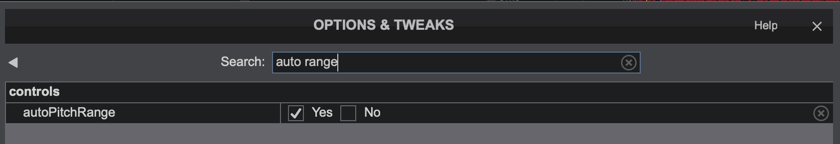

The option is to set Auto Sync on Load (or use the mentioned verb), and probably also set the setting autoBPMRange to true if you are planning to do wide range beatmatching.
If your BPM is actually correct for each song and you sync one to another, then your grids should match up. If your songs don't sound synced, that means your grid in one or both songs is placed incorrectly.
Posted Sun 22 Feb 26 @ 2:56 pm

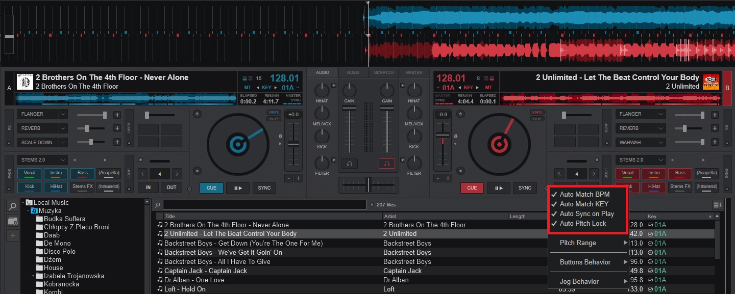

Thank you for your reply - this isn't working correctly. Please see the image below.
Posted Sun 22 Feb 26 @ 4:15 pm

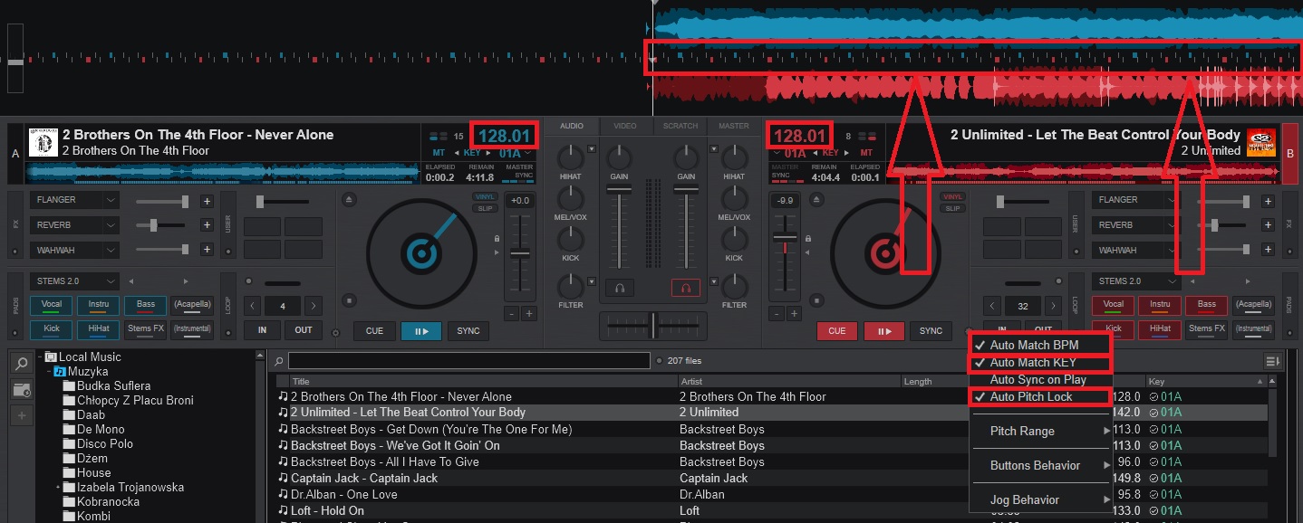

Thank you for your answer - none of the options have helped so far. I would like it to look like the image below.
Of course, I write to make this happen with various songs.

Enable Auto Sync on Play.
Posted Sun 22 Feb 26 @ 5:00 pm

Thank you for your answer - nothing helped either. Please look below.
I would like it to work like in the link below.

Thank you for your answer - I tested on two computers, unfortunately the same thing happens.

Are you asking for, phase syncing and not just beat syncing?
if so, create a custom button with, the script:
phase_sync 4 & sync
use the button, to test if phase syncing, is what you are wishing for.
sidenote: phase syncing is a bit far from, the title, "BPM" , so not sure if that is what you are looking for.
phase_sync 4 & sync
