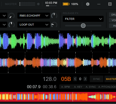

I have 1 issue, and it's minor. I have no master audio displaying on the skin. I use VancedGT, but the issue seems system wide even on default skin. Anyone else? Does anyone have a solution? My other controllers Rane One & Rev-7 do NOT have this problem.
Posted Tue 27 Aug 24 @ 7:06 pm
djnikkofb wrote :
I have no master audio displaying on the skin. Anyone else?
[IMAGE1]
[IMAGE1]
Doesn't show for me either
