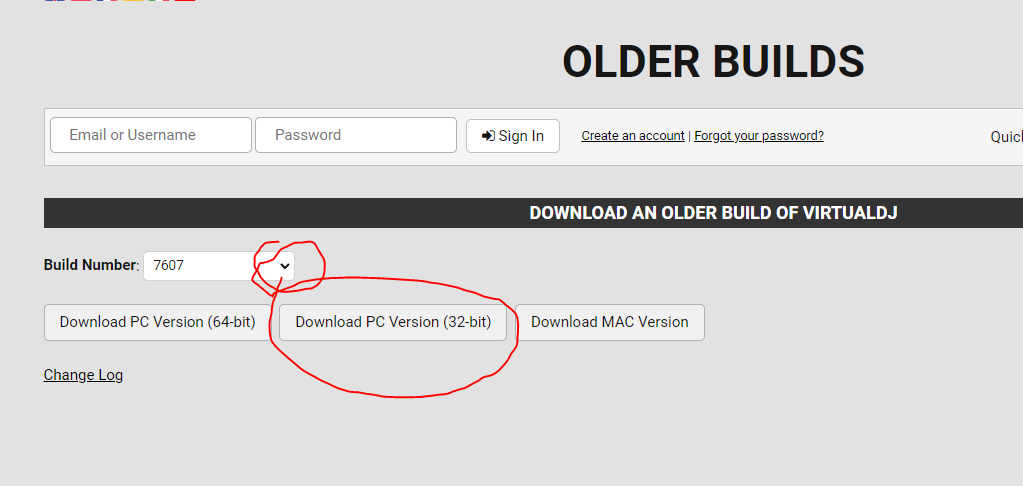

you can download the current 32bit build here
https://virtualdj.com/download/build.html
and no, once again it will not run stems or stems 2.0. read up on that here:
https://virtualdj.com/forums/249163/VirtualDJ_Technical_Support/VirtualDJ_2023___Stems_2_0_-_FAQ.html

the current 32bit version b7607 is what i have to run at the club and is available on the builds download link above.
