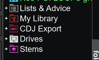

VDJ creates a database on each drive that contains media.
If you use VDJ to copy/ move the tracks/media to an external drive, VDJ will create the corresponding needed database for all your cues, saved loops, and tag info on the external drive during the process.
This is done from the within the Drives folder
(NOTE: the new database will NOT be created if the copy/move is done with the OS, and will not have cues etc)
Important to use VDJ to copy/move the tracks to the external drive.
And the external harddisk can now be connected to any Macbook with Virtual DJ installed. (your goal), since the data base will be on the external drive.
