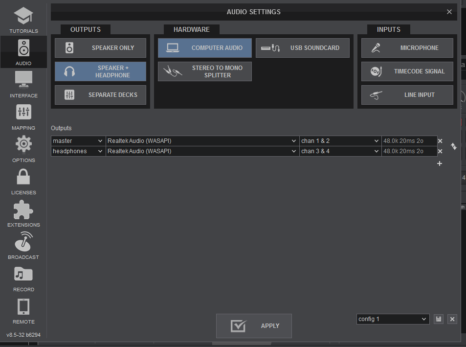

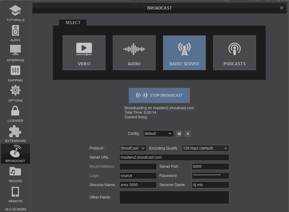

Hi Rune, thanks for your reply.
These are my radio server and audio settings in Virtual DJ. As you can see the server connects and the total time increases as it should when "connected", but then the player on my website does not allow playback.
Any ideas? Thanks for your help.

And just to make sure.... You are broadcasting to a multi channel server.
So your password needs to have the stream ID
For the password field in VirtualDJ you need to use:
password:#streamid
(note the colon and hashtag, that are part of it. VirtualDJ is a Shoutcast v1 client and needs that)
https://help.shoutcast.com/hc/en-us/articles/115002825753-Get-your-station-up-and-running-in-a-few-minutes
password:#streamid

Hi all,
Thanks for your comments.
The player is a JW player. If you can recommend other players that might work better with Virtual DJ? I can take that on board.
Yes I am using the correct password method (stream id:# password) - the connection is made as you can see on the screen grabs above so the password is not the problem.
