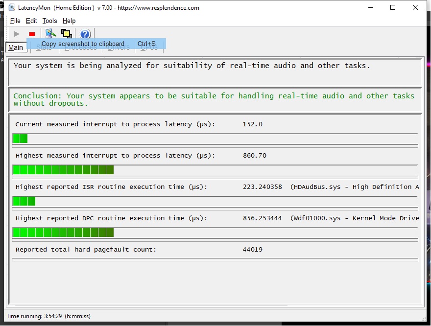

Can also use this tool to check if there is any background apps, drivers or something else hogging resources
https://www.resplendence.com/latencymon

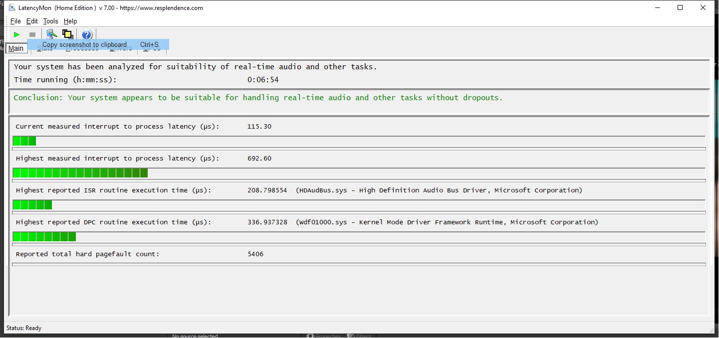

OK thanks will have a read up on that latency checker see what i am looking at

Posted Mon 09 Nov 20 @ 9:59 pm
Looks good...
Did you try a little buffer size in the asio driver settings? 256 or 512 ? :)

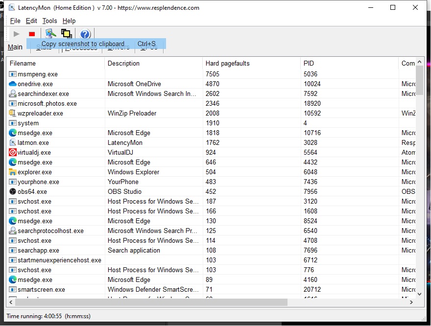

Page faults from vdj in latency checker.

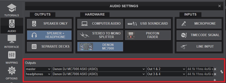

Which asio drivers do you use?
And if you test without asio?
Posted Tue 10 Nov 20 @ 7:03 am
Denon DJ MC7000 Asio, what other could i use?
What I found last night was in audio settings, just hitting apply cleared the distortion.
