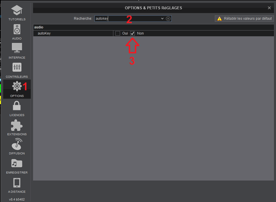

Go to config / options / Autokey and check No

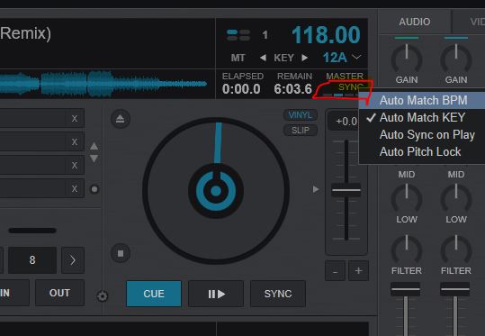

Because you can turn it off on the SYNC menu (Click on the word "SYNC" on default VirtualDJ 2020 skin)
The method provided above does the same job from within VirtualDJ settings.
The SYNC menu does exactly the same, but without needing to go into settings

Because its in the sync menu :)
You also find it in deck options (in all layouts)

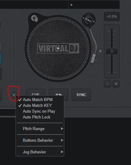

Clicking on SYNC text in Deck Info area (Nr.8 https://virtualdj.com/manuals/virtualdj/interface/decks/trackinfo.html ) in both Pro and Performance default skins, brings the Menu here.
The same Menu is offered from the Deck Options button (Nr.6 https://virtualdj.com/manuals/virtualdj/interface/decks/deckbasics.html )..
