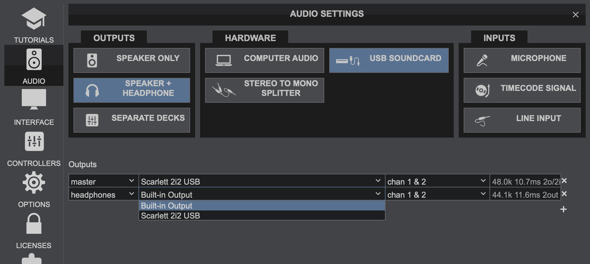

Would it be possible for you to post a screenshot of what the settings should look like if I do this?
Posted Wed 09 Oct 19 @ 6:39 pm
No point of a screen shot because my setup won't look like yours.
Set the audio config to speaker + headphone (top left), which should give you two lines listed in the lower middle section, under 'outputs'.
Set the drop-down next to 'master' to your Scarlett ASIO chan 1&2, then set the drop-down next to 'headphones' to your internal interface (Realtek or whatever) chan 1&2.
Click the big 'apply' button, and also name & save the setup (bottom right) so you can recall it.
Posted Wed 09 Oct 19 @ 7:36 pm

I don't have that option for the headphones drop-down. I tried with the built-in output option and everything is still playing out of the speakers.
Posted Wed 09 Oct 19 @ 10:08 pm
This is why I didn't want to include a screen shot. The likelihood of your computer having exactly the same audio interface as mine is remote (although Realtek is very common). As yours says 'built-in output', that would be the one to use.
The problem may be that as (presumably) your computer OS is using the built-in interface for it's default sound, that's preventing VDJ from using it.
I notice that your sample rates (right hand side) are different for each interface. Best to set them to the same rate if possible.
Posted Wed 09 Oct 19 @ 10:22 pm

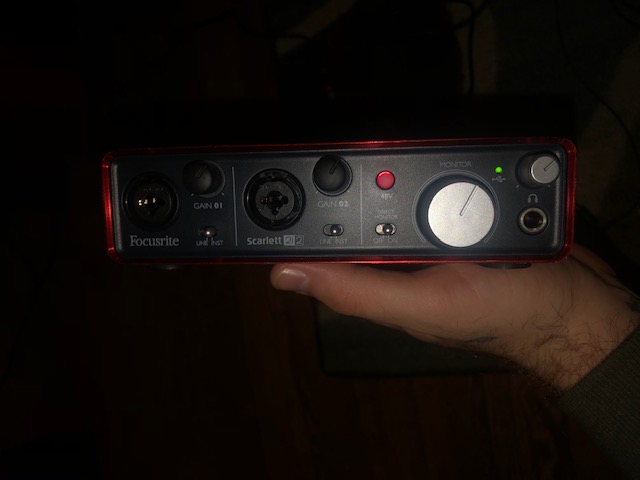

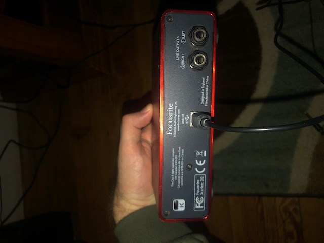

Is there a way to fix the OS using the built-interface for it's default sound? And how do you change the sample rate?
Also, just to make sure I have everything plugged in correctly, could you tell me where to plug the appropriate wires in on the interface, just to cover all bases here.
Thanks for all your help with this.
pictures of the interface for reference:

Just to make sure, you do have the headphones plugged directly into the computer, not the Scarlett? Also you do not have an audio cable coming from the headphone socket of the computer, going into the Scarlett?
Speakers are plugged into the Scarlett, and headphones are plugged into the computer audio socket?
Posted Wed 09 Oct 19 @ 10:41 pm

Headphones are plugged directly into computer audio socket. The speakers are plugged into the Scarlett through the port on the front with the headphones symbol.
Let me know if any of this needs to be switched around?
The audio preferences are set to what you told me to put them to. Just tried again and both tracks, left and right are still coming out of both the speakers and the headphones
