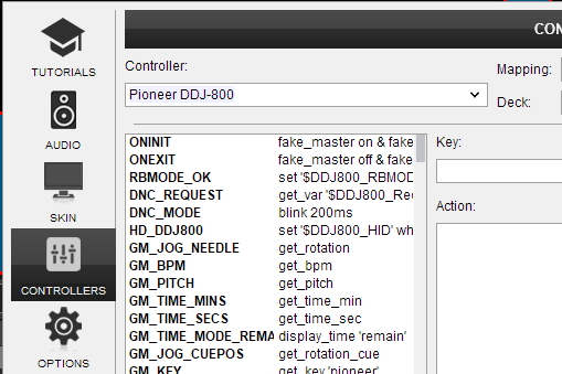

Hmmm, so what does "Initial support for DDJ-800" mean then, I wonder?
[EDIT] It's listed in my 64 bit VDJ (4973).
