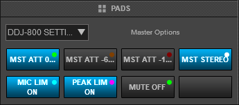

All the settings that are exclusive to Pioneer DDJ-800 will be presented on top, starting with the DDJ800- acronym:

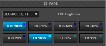

- DDJ800-jogScreenBrightness: Set the desired brightness for the Jog display screen
- DDJ800-fxScreenBrightness: Set the desired brightness for the FX display screen

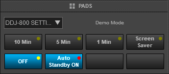

- DDJ800-demoMode: Set the time that the controller will enter 'Demo Mode' if left alone without any operation
- DDJ800-autoStandby: Set whether the device should automatically enter standby mode
- DDJ800-masterOutputAttenuation: Set the desired attenuation level of master output

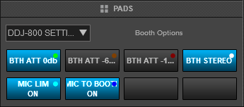

- DDJ800-boothOutputAttenuation: Set the desired attenuation level of booth output
- DDJ800-masterOutputStereo: Set whether the master output should be stereo or monaural
- DDJ800-boothOutputStereo: Set whether the booth output should be stereo or monaural
- DDJ800-masterOutputLimiter: Enable the device built-in Peak Stop Limiter on Master Output
- DDJ800-masterOutputMute: Mute the Master Output of the device
- DDJ800-micToMasterLimiter: Enable a Peak Stop Limiter for the mic when audible on Master Output
- DDJ800-micToBoothLimiter: Enable a Peak Stop Limiter for the mic when audible on Booth Output
- DDJ800-micAudibleToBooth: Set whether the mic should be audible on Booth Output

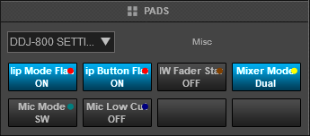

- DDJ800-micMode: Set the desired mic mode. When micMode is "Software" the sound of the mic inputs is routed to VirtualDJ so that you can apply software effects on them. However the latency of the mic sound may rise a little
- DDJ800-micLowCut: Enable a Low Cut Filter on Mic Inputs
- DDJ800-mixerModel: Set the desired mixer mode for 4 decks mixing.
- DDJ800-slipModeFlash: Set whether or not the pads should blink when slip mode gets enabled
- DDJ800-slipButtonLed: Set whether or not the slip button should blink when slip mode gets enabled

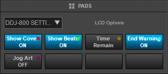

- DDJ800-timeDisplay: Set the desired time display for the Jog Screen of the device
- DDJ800-jogBlinkWarning: Set whether or not the Jog Screen should blink as a warning near the end of the track
- DDJ800-jogScreenShowBeats: Set whether or not the Beat Scope should be visible on Jog display screen
- DDJ800-jogScreenShowCover: Set whether or not the Artwork should be visible on Jog display screen
- DDJ800-jogScreenMode: Set the default operation mode for the Jog display screen
