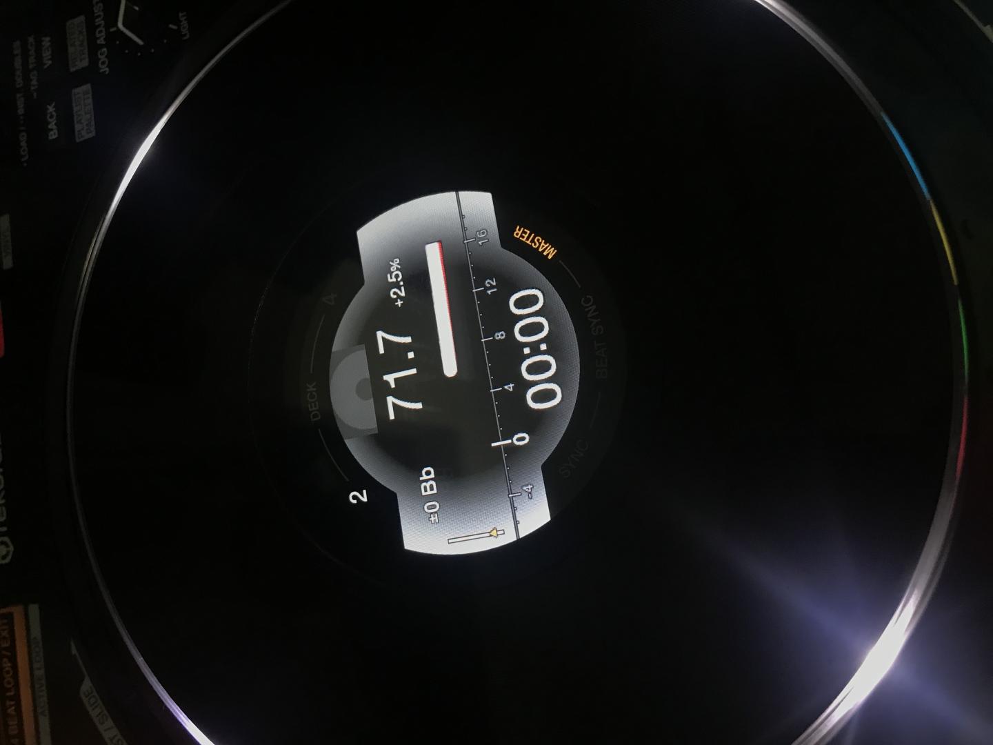

hi again friends. I would like to know how I can change the information that comes out in the jog wheels of my ddj 1000 since I want to see the remaining time and not the one that is running on the computer. I do not know if they understand me? I want the time to be seen in 3-2-1 and not in 1-2-3.

The DDJ-1000 "Settings" is a Page in the PADS section of the skin (default or custom that support Pads), as shown in manual http://www.virtualdj.com/manuals/hardware/pioneer/ddj1000/settings.html

Hi, I Have Pioneer DDJ 1000 Controller When I Activated Vinyl Mode I want To See Directly On Screen How Can I Make It. Or Can I Change Screen Color Noticeably Different When I Activated Vinyl Mode.
Posted Tue 25 Jun 19 @ 1:53 am
That's not possible due to firmware limitations of the device itself
