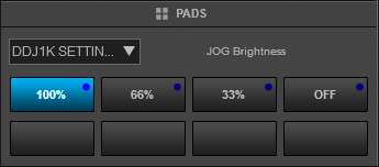

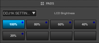

- DDJ1000-jogScreenBrightness: Set the desired brightness for the Jog display screen
- DDJ1000-fxScreenBrightness: Set the desired brightness for the FX display screen
- DDJ1000-jogRingBrightness: Set the desired brightness for the Jog ring

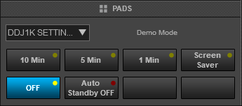

- DDJ1000-demoMode: Set the time that the controller will enter 'Demo Mode' if left alone without any operation
- DDJ1000-autoStandby: Set whether the device should automatically enter standby mode

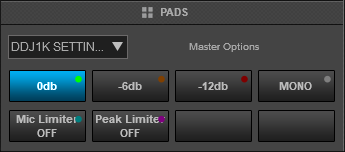

- DDJ1000-masterOutputAttenuation: Set the desired attenuation level of master output

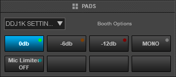

- DDJ1000-boothOutputAttenuation: Set the desired attenuation level of booth output
- DDJ1000-masterOutputStereo: Set whether the master output should be stereo or monaural
- DDJ1000-boothOutputStereo: Set whether the booth output should be stereo or monaural
- DDJ1000-masterOutputLimiter: Enable the device built-in Peak Stop Limiter on Master Output

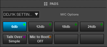

- DDJ1000-micToMasterLimiter: Enable a Peak Stop Limiter for the mic when audible on Master Output
- DDJ1000-micToBoothLimiter: Enable a Peak Stop Limiter for the mic when audible on Booth Output
- DDJ1000-micAudibleToBooth: Set whether the mic should be audible on Booth Output
- DDJ1000-micTalkOverLevel: Set the threshold for mic talkover function

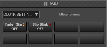

- DDJ1000-slipModeFlash: Set whether or not the pads should blink when slip mode gets enabled
- DDJ1000-slipButtonLed: Set whether or not the slip button should blink when slip mode gets enabled

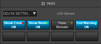

- DDJ1000-timeDisplay: Set the desired time display for the Jog Screen of the device
- DDJ1000-jogBlinkWarning: Set whether or not the Jog Ring should blink as a warning near the end of the track
- DDJ1000-jogScreenShowBeats: Set whether or not the Beat Scope should be visible on Jog display screen
- DDJ1000-jogScreenShowCover: Set whether or not the Artwork should be visible on Jog display screen
