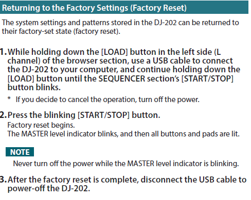

The sequencer is triggering the VDJ samples somehow. I can hear the Roland internal drum samples play but on some (most) loops, I also get blasted with applause, airhorn and the siren samples that come with VDJ. The samples appear in sequence with the drums but the last played sample continues after pressing the sequencer start/stop button. So the Roland drums will have stopped but the airhorn will continue untill the sample ends.
I have reset my 'options' to 'factory defaults' just in case I messed up something but the issue remains after restarting VDJ.

It's not bad to get an applause sometimes ! ..hehe kidding.
The TR Sequences can be a mixture of TR Instruments and VDJ Samples and you have probably over-recorded an existing Pattern by adding VDJ Samples. Unfortunately, there is no easy way to edit a Pattern - havent found out that myself, nor the manual is clear on how to do that), so best would be to reset the Patterns to the default settings.
Here is a snapshot from the menual which u can find here .. https://www.roland.com/us/products/dj-202/support/
(from page 16)
Advised to also read pages 13 & 14, to know how the TR Sequencer works.

Thanks I did a factory reset and the latest firmware update whilst I was at it. Definitely worked and I have managed to sort out my issues with the sampler. Comes down to selecting the +param when in step or real time recording mode. The -param selects the VDJ loaded samples and the +para the roland onboard samples.
Factory reset is akin to using a shotgun to kill a mosquito though. ;)
Better to delete a pattern in pattern mode: shift + sequencer then -param + pattern (1~8) or shift +pattern (9~16)
