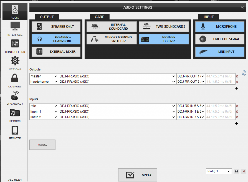

While I was at the 2017 DJ Expo in Atlantic City I spoke to the Pioneer guys. The DDJ-SR is made for Serato and the DDJ-RR is made for Rekordbox and Virtual. I bought the RR and it works great but I haven't figured out how to get sound from the CUE yet. I know CUE works because it works for me in Rekordbox. Also, according to the configuration that Virtual DJ wrote in these instructions ( https://virtualdj.com/manuals/hardware/pioneer/ddjrr/inputs.html ) the sound settings are supposed to be set to DDJ-RR ASIO (ASIO) but no sound comes from that in any channel. The controller gives me a second setting of PIONEER DDJ-RR (WASAPI) and I do get sound from that setting, but still no CUE. The CUE light comes on but I don't hear anything. The HEADPHONES MIXING knob will adjust louder toward MASTER OUT and fade to black toward CUE.
Try posting a screenshot of your Audio screen in the VDJ settings
It should look something like the one below - but that only works if your have your ASIO drivers working first
