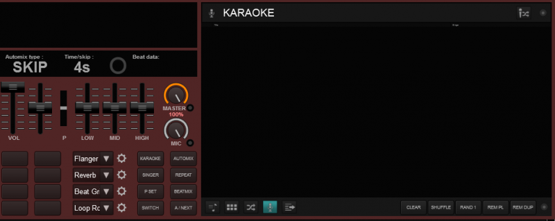

LOVE the update, but there's a small bug on the karaoke screen...
The "Title" and "Singer" are VERY tiny, and this is on a 24" screen.
But I don't know if this has to do with the pending karaoke additions discussed in another thread that are coming out in the next update.
P.S. Atomix needs to make this the default skin. :)
Posted Mon 02 May 16 @ 3:07 pm
Well it's not really a bug, I decided to make the columns headers as tinier as possible (but to keep them clickable for an eventual reorder) in order to make the most possible room for songs inputs, and because this sideview area is not that high. In the other hand, as long as you know what the columns are assigned to, it doesn't really matter they have a huge height with big letters.

@BigDawg, if you're comfortable with editing the skin XML file, you could just remove the font statements from the <sideview> code for the automix / karaoke view.

Oh yes, true, forgot to mention, thanks Groovin :)

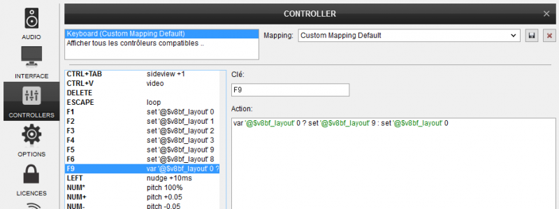

Hi Fruit,
First thanks for the browser - i know you have heard it before but it really is easier on the eyes.
The extended browser is good good tired eyes too and I'm trying to do the same thing to map it to a hot key but with no success can you help please? I have mapped the
class="sourcecode">var '@$v8bf_layout' 0 ? set '@$v8bf_layout' 9 : set '@$v8bf_layout' 0v>
to a hot hot key but it switches from 2 deck to karaoke and doesn't toggle back. I've only just downloaded the skin so I guess it's up to date?

This works fine here, just toggles between 2-decks and extended browser.

Thanks Fruit,
That does indeed work, I must have been doing something stupid but the stupid thing is I don't know what it was. Any way thanks again, the skin is perfect for my needs and being able to toggle the browser will make it a pleasure to work with.

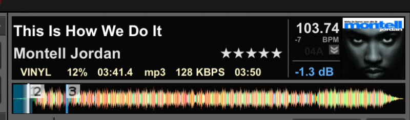

Am I missing a setting or is it normal that my cue points on the decks don't change color to match what I colored the cues in POI?
The just stay red. Isn't that the point of setting the cue points to different colors? Or am I missing something?

You won't be able to do the same thing with only one shortcut. But with two :
"F9" wrote :
var '@$v8bf_layout' 0 ? set '@$v8bf_layout' 9 & set '$fromdecks' 2 : var '@$v8bf_layout' 2 ? set '@$v8bf_layout' 9 & set '$fromdecks' 4 : var '@$v8bf_layout' 9 ? var_equal '$fromdecks' 2 ? set '$fromdecks' 0 & set '@$v8bf_layout' 0 : var_equal '$fromdecks' 4 ? set '$fromdecks' 0 & set '@$v8bf_layout' 2 : set '@$v8bf_layout' 0 : set '@$v8bf_layout' 0
"SHIFT+F9" wrote :
browser_window 'folders,songs,automix'

Colored cue buttons will be offered in 0.8.

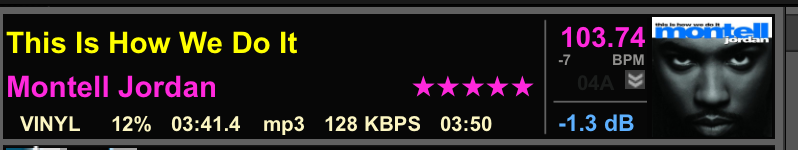

I change the color comment rating and artist,to see rating artist and song together.can you change or add as a option
