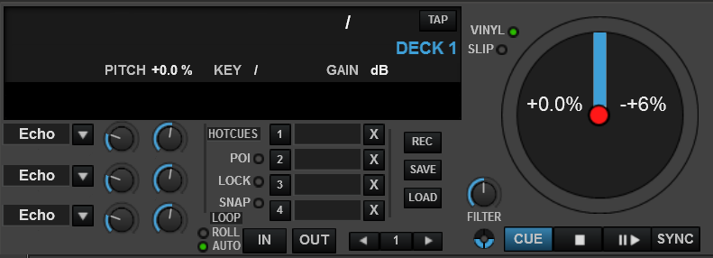

groovindj wrote :
Three FX slots, end result:
I want this!

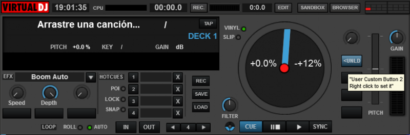

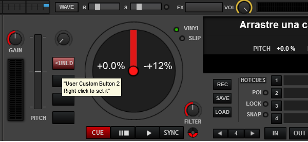

Try to use the wiki to build my own UNLOAD button, find that on booth decks, have the same button number, so it works left or right with the same, I mean it duplicates the button. Here two pictures edited.
As your can see the tooltip are the same button and works as the same button. Is this only my bad or need to update the skin?
See after my vacations...
Cheers
Ju@n

This is UserButton 2 once DECK1 and the other DECK2. When your action is "unload" then removed the left button the left deck and the right button the right deck ;).
