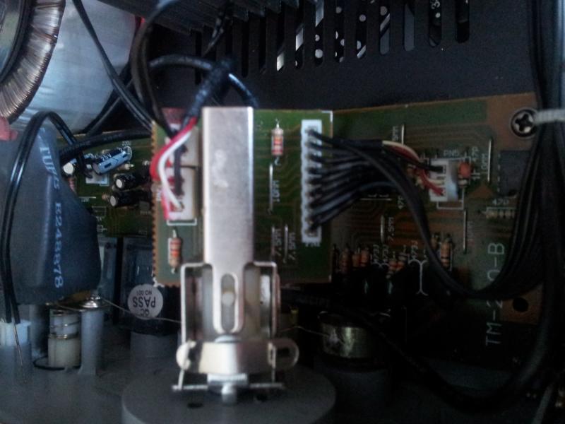

what i did find though is, if i place my finger on the back of the borrd attached to the input selector, i get perfect audio, however, i loose volume control.
also being me... i dont really know a great deal about the whole electronics and circuitry thats inside, so my uneducated guess is i either have a dodgey input selector, a dodge volume control, or both...

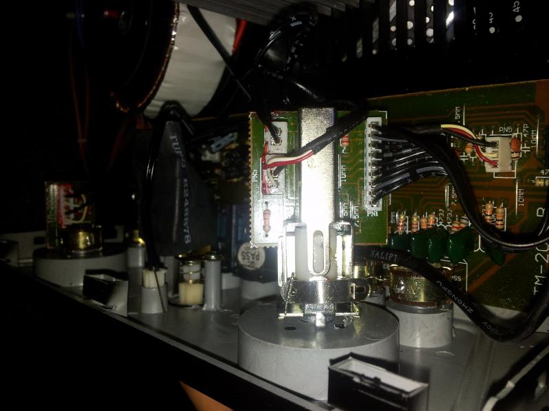

daz, the first three are the selector switch, the fourth the input board, the fifth the whole internals.

Its odd that none of the RCA inputs are working. Could be the output contacts on the selector switch I spose??
Looking at the input selector board the output from the selector is on the red,white and black wires. You could try disconnecting the cable (Looks like its PN3) that runs from the selector to the main PCB. Try feeding a signal (Low Level to start with) directly into that connector. That will take the selector out of the equation. If you still can't get the sound through can you do another pic as close up as possible on the main circuit board where that cable plugs into the main board.
Looks like the buffer IC I was talking about earlyer is either just to the right of where the selector output cable plugs in to the main board or to the far right of the main board where the volume control cable is plugged in.
Let me know how you get on :-)

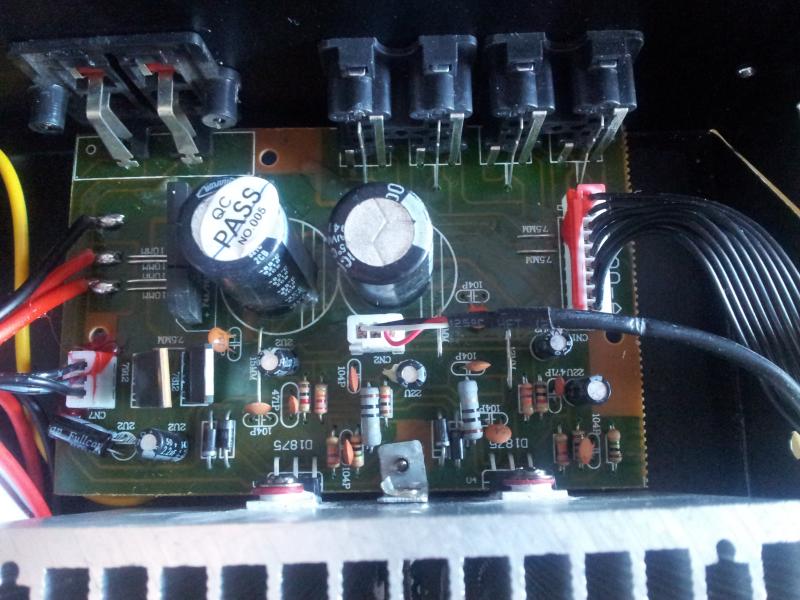

Something else is bugging me about how your amp is behaving. I notice that on the power amp board there are two Voltage regulator IC's. These will provide a + and - rail for the pre amp chips. If one of these has failed it could cause some very odd behavior.
They are the 3 pin devices to the left of the power amp board. it looks like they ar 7812 so 12 Volt regulators.
Output would seem to be on connector CN7. You could check with a meter set to DC Volts on say the 50V range to see if both Pos and Neg supplies are present.
Check this by going between an Audio ground and each pin on CN7. One should read 12Volts and the other should read - 12 Volts. (Note that if you use a moving coil meter that you will need to swap over your test leads as the meter will try to move backwards) Digital meter should show + or -. There are 3 wires on CN7 so one will be the ground or 0 Volt connection. So should show No Volts.
Just a last thought. Keeping an eye on safety as I do. Perhaps if this goes much further we should look at using PM's. Poping the lid off gear and diving in is not for everyone after all :-D

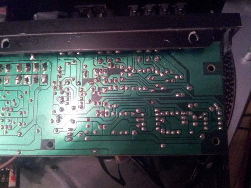

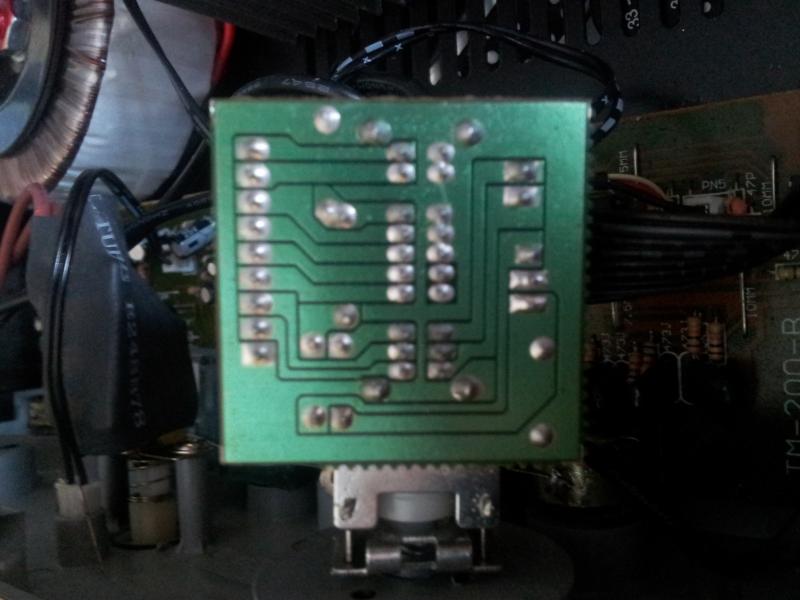

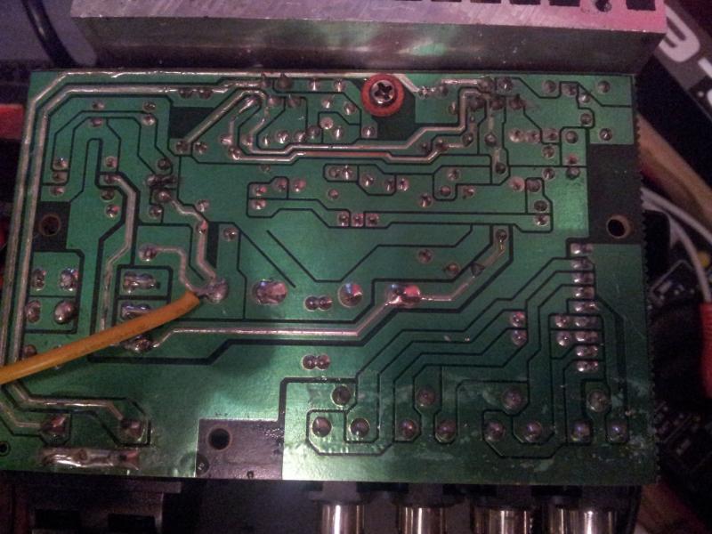

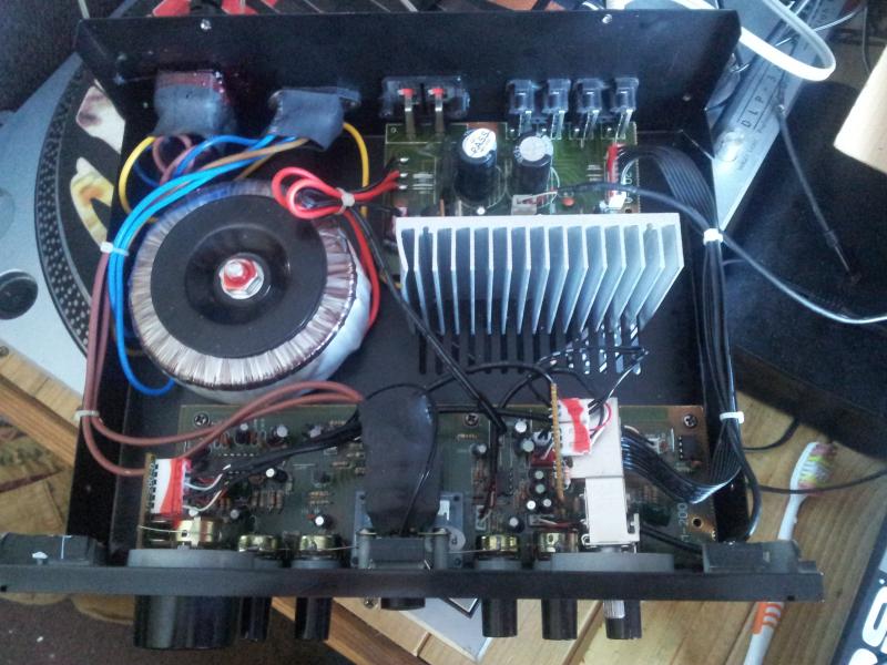

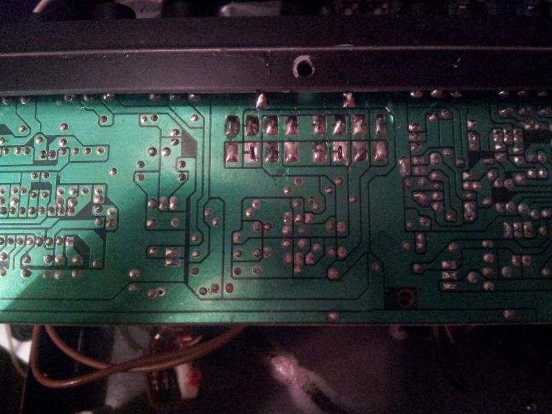

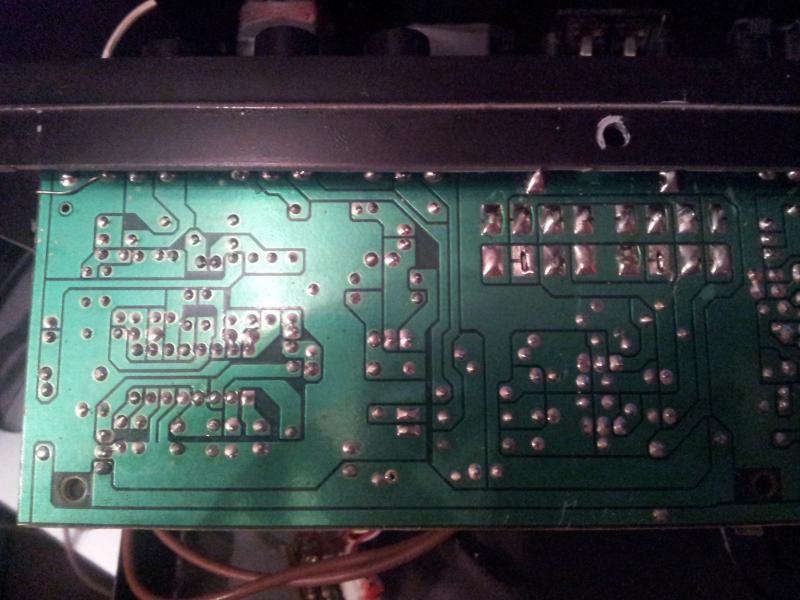

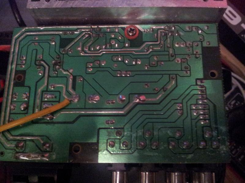

i will run the tests you mentioned just as sonn as i put the amp back together, i decided to tear it down a bit further and inspact the reverse sides of the boards. i discovered a couple of dry soulders, two which seemed to be completely missing and two that0didnt seem to have a great connection. this was all on the pcb.
on the amp board the underside looks a bit worse for wear, although im not sure if its just bad workmanship or damage.
there seems to ba a lot of surface bubbles on the underside of the amp board.
which audio ground would you recomend i use for the testing on cn7?
also heres the pics of the reverse sides of the boards.
