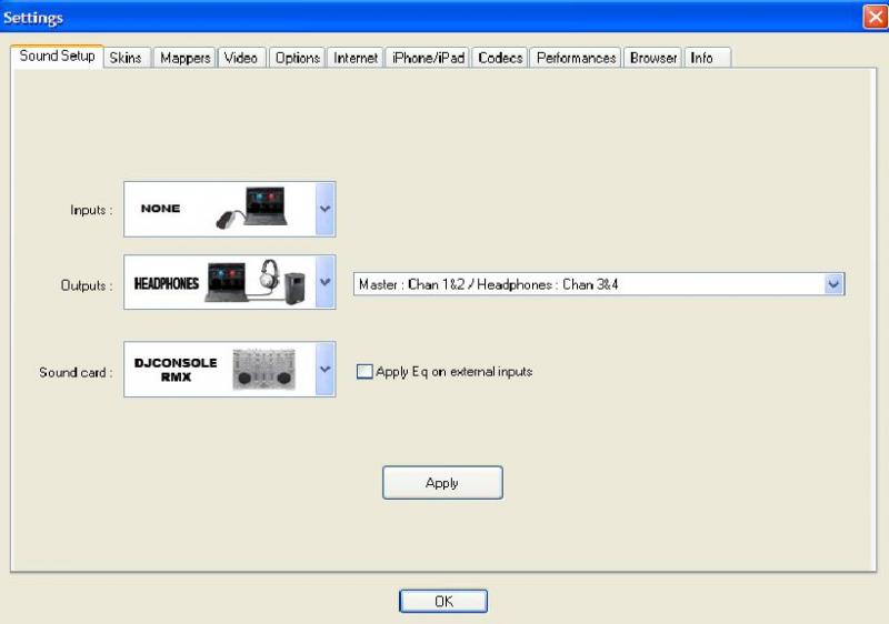

I setup Mixtrackpro as Outputs: Master : Chan 1&2 / Headphone : Chan 3&4 and then the headphones worked, but I couldn't find a way to isolate the preview from the playing deck, so both channels are heard and the "Cue Mix" pot does nothing to control the source channels...?
I couldn't get it to work in Advance soundcard setup at all, I have a Mk2 and have no problems in advance to config and it works as exspected, but no luck with Mixtrackpro setup as a headphone card...

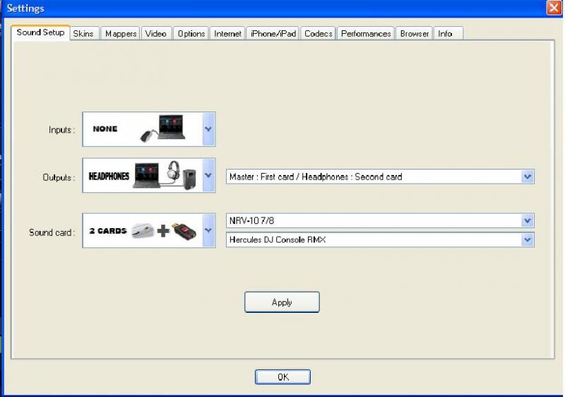

Tried these setting and still nothing, only works in a single card setting for both Master and headphone...
This setting does not work...
This setting doesn't work eithere...

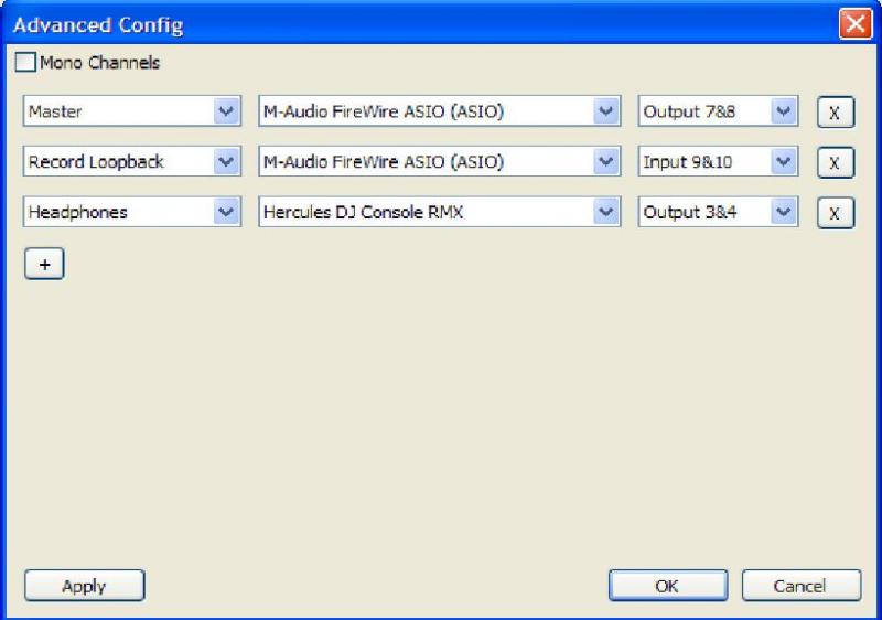

Dam, just installed 7.5 hoping that woud solve my Rmx headphone problem and still can't get it to work with a two card configuration,
Can someone tell me if this is possible using the Herculer Dj Console Rmx as a second card just for headphones, using channels 3&4.?

Try opening the Hercules control panel and switching the setting from WDM to ASIO. Then reconfigure inside the software using the Hercules ASIO drivers instead as it looks like it's currently set in WDM mode.

@superaceman
This will present a problem if you look at my advance settings above, because my Master NRX-10 soundcard mixer has a ASIO driver that is running, so if I also activate the Rmx ASIO driver this will cause a conflict in soundcard settings?

no, you need to set the 2 cardds options first before setting your advanced options, this should allow you to route mains via one card and phones via another.
Posted Thu 11 Aug 11 @ 1:13 pm
You don't need to set the 2 card option, that's the whole point on the advanced config, so you can route your soundcards. Atleast in my mind it makes sense, plus I've never had to set it to the 2 card option and then do the same in the advanced config.

Can you give me a step by step how to get the souncard config to do what you are decribing, once you set a two card setup you can't go into advance, unless there is a specific way of doing it, which I haven't figured out...
Thanks,
Joey....
Posted Thu 11 Aug 11 @ 4:14 pm
i just setup the 2 card way, then goto advanced as usual and route my audio through which ever channels i want.
