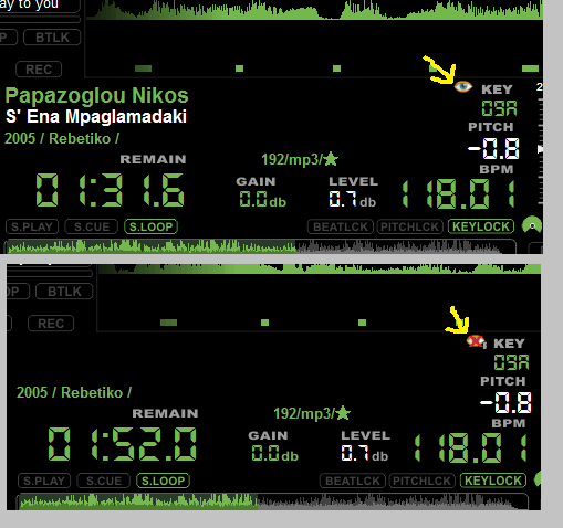

1. Added New Hidden Title Panels
2. Added various browser font sized panels.
1. Artist and Title are now in panel, which can be hidden in case you don't want to show those infos to public.
Those 2 panels are toggling using that eye icon, but the Grom's users would like this keyboard shortcut too ;)
skin_panel 'left_title_hidden' on ? skin_panel 'left_title_visible' on & skin_panel 'right_title_visible' on : skin_panel 'left_title_hidden' on & skin_panel 'right_title_hidden' on

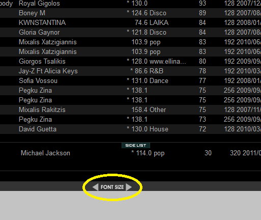

2. Many users ask often how to change the font size in browser. Now its easier ! Grom includes 14,15,16,17 and 18 font sizes, and you can easily change that using those buttons on the bottom of the skin.
In case you need a script for those buttons, let me know. It has to do with an initial adjustment, so mouse is permitted here :)
