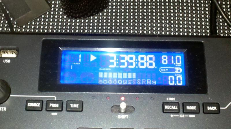

Huey...grrrr...they don't show up on my NDX800's screens....grrrrrrrrrrrrrr....grrrrrrrrrrrrrrrrrrrrrrrrrrrrrrrrr...
Bud, can you take a quick pic showing what the Mixdeck screens show, so that I can compare it to what is shown on the NDX's...
In fact...can you post the action for the TEXT element from your Mixdeck mapper...as I have "get artist-title" but this does not seem to exist as a VDJScript Verb...
Posted Sun 13 Feb 11 @ 5:31 pm
Hey Simon - appreciate the heads up. Thanks!!
Posted Sun 13 Feb 11 @ 8:05 pm
Here's my display,
It shows the track name and artist, bpm, keylock, pitch %, hot cues, what # deck your on, time (elapsed remain, which ever 1 I want) and play, pause and stop. Id like it if it showed the actual "key" of the track.
Heres what the mapper says,

<map value="TEXT" action="get artist-title" />
<map value="LCD_BPM_DOT" action="on" />
<map value="LED_PITCH_ZERO" action="get pitch_zero 0.5%" />
<map value="RING_PAT2" action="get rotation" />
Hope that helps
Huey
Hmm, I just noticed it has "get_Key_modifer" but the key doesnt show up on my screen???
Posted Sun 13 Feb 11 @ 11:58 pm
if the displays are not working, please try installing the latest firmware from http://www.numark.com/ndx800
Also, make sure that you have the latest VirtualDJ v7.0.2 installed: http://www.virtualdj.com/download/updates.html
Posted Mon 14 Feb 11 @ 7:09 am
@ Support...I have the latest version of VDJ and also the latest FW for the NDX800 (028)...in fairness the title-artist has never been displayed on my NDX800's (regardless of VDJ version or FW version), everything else displays ok (with the exception of the "get key_modifier", which it seems is also true on the Mixdeck).
Posted Mon 14 Feb 11 @ 8:09 am
Im not even sure if "Get Key Modifier" works...........I tried to have it show up after the title and artist but got nothing..... After taking a closer look at the lcd screen itself I don't think its even possible to have the key show as a letter? There's just not enough things in there (the digital part that makes the letters or numbers ) it would show the numbered version of a key but I can't get it to work either..........
Simon let me know if you find a fix, Thanks
Huey
Huey
Posted Mon 14 Feb 11 @ 8:59 am
