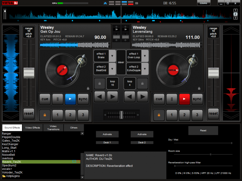

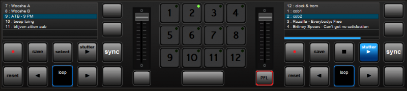

Hi,
Still working on it, but for now, this is what I have.
As you can see I made some smart_cue buttons and for the effects I made a button to go to the effects-page(no browser or sampler enz).
Also some smart-buttons like play loop and cue. Ow.. and ofcourse the pich-bend buttons on top and bellow the scratchwaves.
So far..

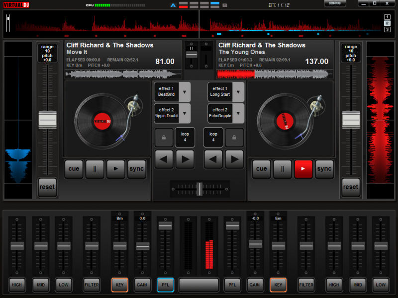

Hi all,
I made video-pannels on the same place as the vinyl is and I had to find a way for the sampler to use it easier(bigger buttons).
So another pannel for the sampler(well, 25 exactly....lol..., see picca)
I still have issues with the browser. When I switch pannels, a flickerring box at the top-left-corner shows up for a very short time.
But I did not put something there. My browser-pannels (you can't see) are out of the screen at x=1024 y=35.
For the rest....It works fantastic.....

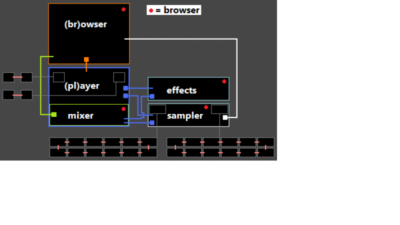

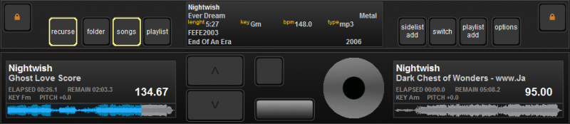

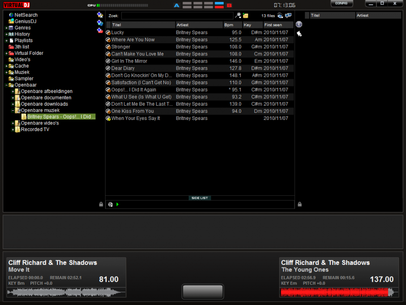

update
The browser part.
The big wheel is for scroll.
I tried to find a way for fast scrolling and I have to say, with touchscreen it works but with mousse it is not recomended.
The options button on the right shows different options. Depending on the view.
The boxes for the decks are buttons to load a song. And the box at the center is the browsed info, also clickable for editing.

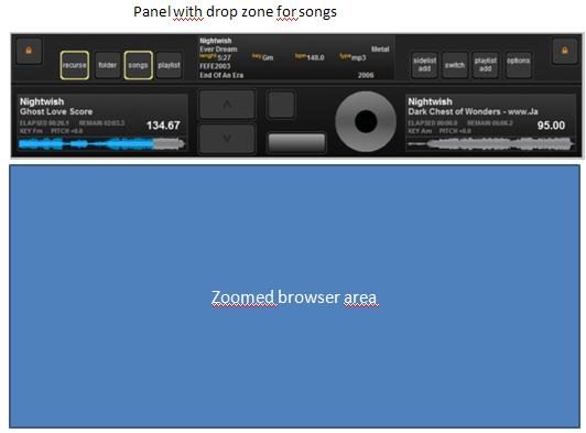

just bought a touch screen, PM me if you need test persons.
Very interesting part is indeed the scrolling in the browser and assigning a song to a deck. Mainly this is the painlfull part on current skins when using touch.
just a question, will there be a big button to activate the browser zoom function?
And once you are in Zoom mode, would it be possible to use panels.
- Your panel with the scrolling wheel and dropzonde to add the song to the appropriate deck (Would love to see it for 4 decks)
- Browser area itself
So when you scroll with the wheel, it should go to the list of songs
(see picture)
(see picture)

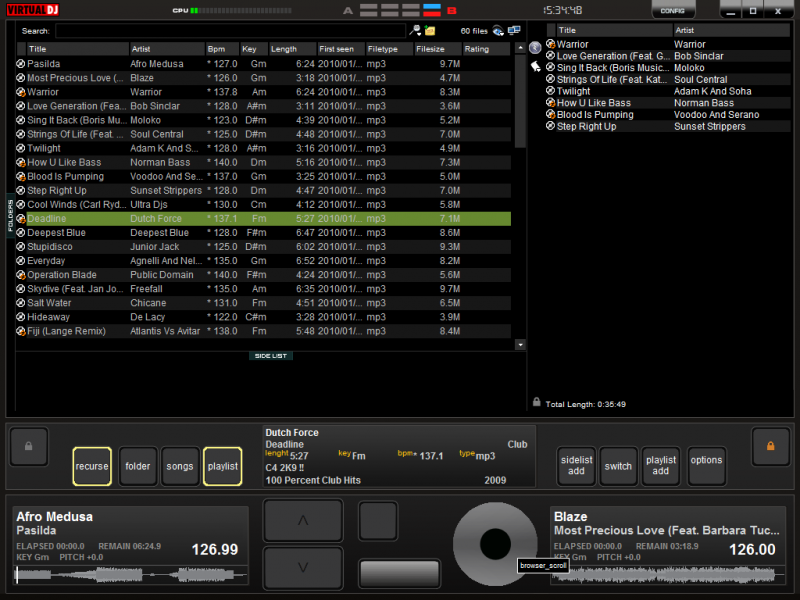

@ Johans,
Hi,
No, I do not use the browser-zoom because when browser-zoom is active, there is nothing left over of the screen, and you can not resize it.
This is what I have now..
The scroll wheel works good with the songs-view, sidelist and playlist. It works like a round slider.
When focused on folders you can touch the weel but it only goes down. But the scroll-buttons are working to.
Believe me. It works better then without..hahaha.
About the four decks. I can make four decks but I have to finnish this one first.
Latest things added:
dropzones.
Special load-deck fuction for the decks in the player-panel. It load the first track from the playlist (fast loading without switching panels).

I finnish this one first before starting another size.
I had a little issue with the browser. I had to make a schedule for all the pannels, so I could find where the problem was.
Now I have this, so why not put it in this topic.
Today I found a problem with the Firetext-plugin. It doesn't fit in the litle browser. So I have to make buttons for the big browser.
It's not easy in use but bether than no use.

Hi John, thanks for the opportunity to test the skin on your behalf.
In a word it's brilliant. Spent over an hour working from the ipad and it works perfectly. Only change I would request is making the browser tracks with bigger text and more of a gap between them. It's still a bit tight to click with a finger although the scroll wheel is a great idea.
Here are a couple of photos of your skin running live on the ipad. This will help a lot in the club this weekend as I am in the restaurant Friday night and walk about a lot getting requests.
Thanks
Keith
Thanks
Keith

Hi all,
@ kradcliffe
Thanks for your input and time.
First..I tought the i-Pad was running Mac, but I see the windows-layout.
The text-size is to small. I was thinking of that yesterday. I change the size of the text in the browser.
@djdad
Thanks man, I was looking at your video yesterday of your touchscreen skin. Amazing.
Still trying to find a way for your round sliders(no succes at all)
The smartcue-buttons will be half the size, because I mis the delete-cue function. And I'm looking for space to make the master video-window.
That all for now, I've gotta go.
