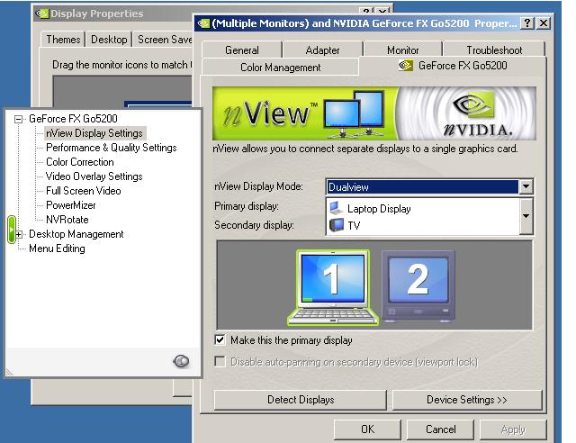

this is what i have.
Posted Sun 31 Jan 10 @ 2:18 pm
OK, that looks correct ... how about leave everything connected and do a reboot. Does it now work correctly ?

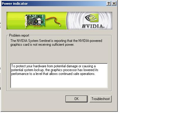

ok, i uninstalled and reinstalled the video driver and got this weird message for a laptop
and also now get the error in vdj when selecting output for video to my tv "error in the video driver". I swear I have the wrong driver but if I go to Dell and put in my service number it only pulls up that one driver. That pic looks like a tower card.
