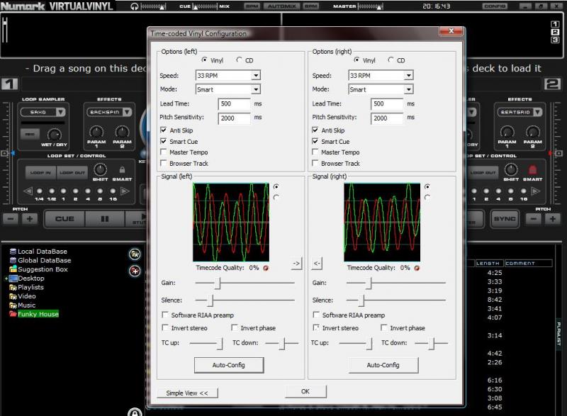

Ok now it has the wave but no quality I need urgent help. See pic below
Posted Mon 05 Jan 09 @ 2:21 pm

You should download the latest version from the download center. The screen shots you are showing are from an old version.
https://virtualdj.com/download/updates.html
Posted Mon 05 Jan 09 @ 2:32 pm
it shouldnt really matter though. I tried it but it still wasn't working so I uninstalled it and reinustalled my disc.
Posted Mon 05 Jan 09 @ 3:03 pm
Have you tried Auto-Config? I think the TC Up may be too high.
Posted Mon 05 Jan 09 @ 4:12 pm
Switch your VV box to line (from phono to lline) then click Software RIAA Preamp, those, try click invert phase also then auticonfig. If you can get a signal maybe try to adjust the TC up or down to fine tune it and to have a stable 100% signal.
Posted Tue 06 Jan 09 @ 2:02 am

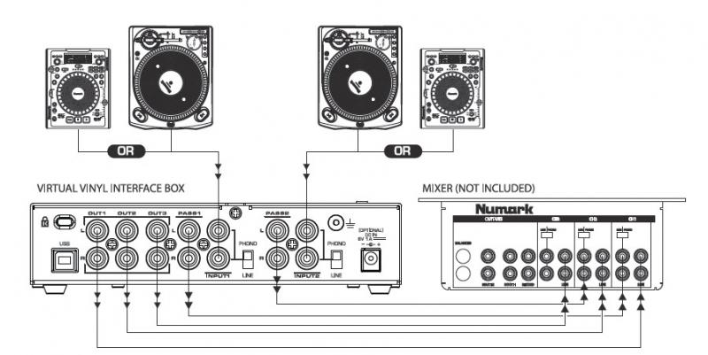

Please check on the diagram below if you have the properly set your machine up:
You have to fine adjust the TC up or down to get a stable signal. Small increment or decrement with the slides can have a big effect with the signal quality.
BTW I'm using the VDJ Timecode V4, try it also.
Lastly check your needle...
Posted Wed 07 Jan 09 @ 3:57 am
