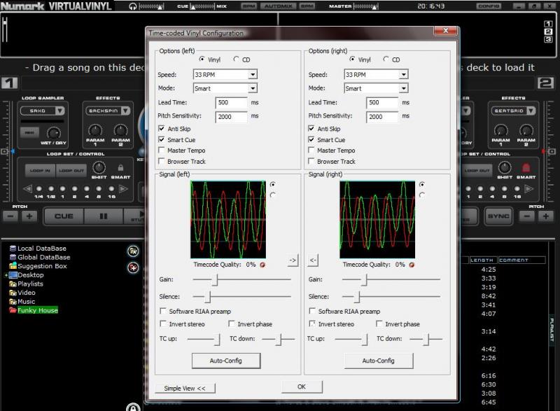

Ok now it has the wave but no quality I need urgent help. See pic below
Posted Mon 05 Jan 09 @ 2:21 pm

You should download the latest version from the download center. The screen shots you are showing are from an old version.

Have you tried Auto-Config? I think the TC Up may be too high.
Posted Mon 05 Jan 09 @ 4:12 pm
Switch your VV box to line (from phono to lline) then click Software RIAA Preamp, those, try click invert phase also then auticonfig. If you can get a signal maybe try to adjust the TC up or down to fine tune it and to have a stable 100% signal.
Posted Tue 06 Jan 09 @ 2:02 am

well they control the song but their is no song playing (muffled and static and whatever else) and the quality varies and when I press auto-config the quality goes to 0%
Posted Tue 06 Jan 09 @ 12:15 pm

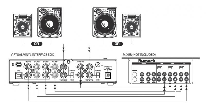

Please check on the diagram below if you have the properly set your machine up:
You have to fine adjust the TC up or down to get a stable signal. Small increment or decrement with the slides can have a big effect with the signal quality.

I dont remember which version but there was a funky bug in the auto config. As far as I can see every looks good, I would install the lastest version and make sure you have the soundcard plugged in and active before running virtual vinyl.
