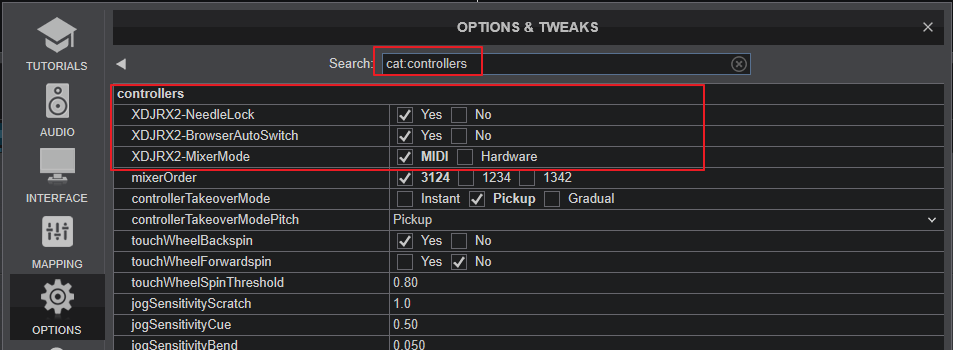

Goto VirtualDJ Settings -> OPTIONS tab and select the CONTROLLER category
MIDI MIXER MODE
Select the MIDI Mixer mode value (default mode) for the XDJRX2-Mixermode Setting. In this mode the Audio setup of VirtualDJ needs to be as Master & Headphones as per the image below.

Select the Hardware Mixer mode[ value for the XDJRX2-Mixermode setting . In this mode the Audio setup of VirtualDJ needs to be as External Mixer as per the image below.

In the same Settings window, other XDJ-RX2 related settings can be defined.
NEEDLE LOCK
When XDJRX2-NeedleLock setting is set to Yes (default value), the Needle is locked and touching the Song Progress will have no effect. This option is useful to prevent accidental track jumps when the Needle (Song Progress Wave on Display) is accidentally touched
When set to No, the Needle is unlocked and you can touch the Song Progress wave and jump to a position on the loaded track.
BROWSER VIEW SWITCH
When XDJRX2-BrowserAutoSwitch setting is enabled (default selection), the Browser view Switch is set to Automatic. In this mode, when a Track is selected and loaded to a Deck, the Decks/Waves view will automatically offered without pressing any other buttons.
When disabled, the Browser view will remain active after loading a track and the BROWSER button above the Display needs to be manually pressed to return to the Decks/Waves view.
VU-METER TYPE
When XDJRX2-VUMeterType setting is is set to Linear (default selection), the Deck VU meters will indicate the pre-fader deck output in linear scale.
When set to Log, the Deck VU meters will indicate the pre-fader deck output in logarithmic scale
