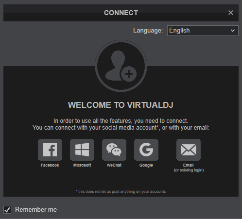

Once VirtualDJ is launched, a Connect window will appear to enter your Account credentials.
A Pro Infinity, a Pro Subscription or a Home License is required to fully use the Numark Party Mix III. Without any of the above Licenses, the controller will operate for 10 minutes each time you restart VirtualDJ.
https://virtualdj.com/buy/

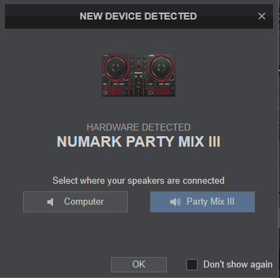

A detection window will appear when the unit is first connected with VirtualDJ, verifying proper connection.

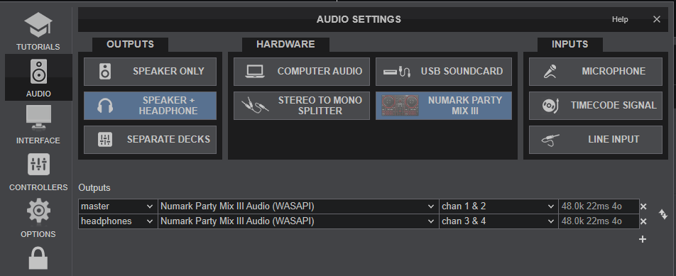

Click on the "Party Mix III " if your speakers are connected to the Main Output at the right side of the device.
You can still make changes in the Audio setup from VirtualDJ Settings->AUDIO tab.
Press OK.
The device is now ready to operate.

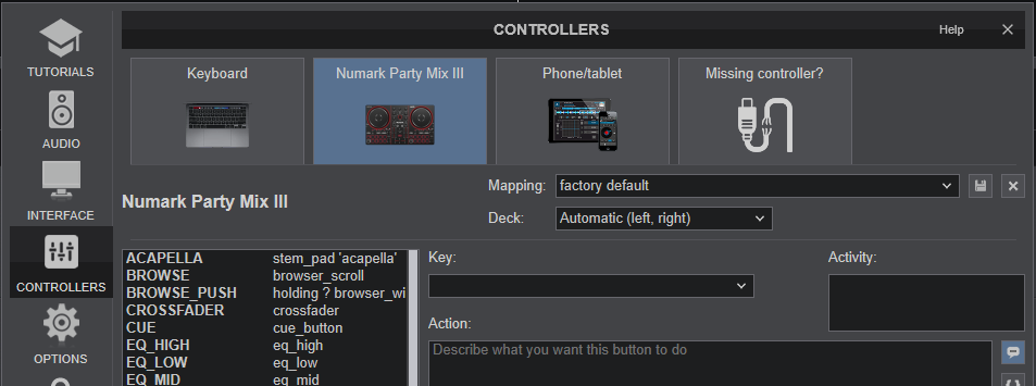

MIDI Operation
The unit should be visible in the CONTROLLERS tab of Config and the “factory default” available/selected from the Mappings drop-down list.
The factory default Mapping offers the functions described in this Manual, however those can be adjusted to your needs via VDJ Script actions.
Find more details at https://virtualdj.com/wiki/VDJscript.html
AUDIO SETUP
The device has a pre-defined Audio setup and a special button in the AUDIO tab of Config to provide that.
For further software settings please refer to the User Guide of VirtualDJ.
