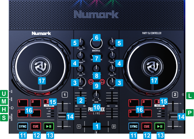

CONTROLS
KEY
ACTION
P ON/OFF
Power on after all other connections are done.
S SPEAKERS
Set to On, if you wish to use the built-in speakers.
U USB
Connect the PartyMix Live with a USB port of your computer using the provided USB cable
M MAIN
Connect a pair of amplified speakers using a proper 1/8" cable
H HEADPHONES SOCKET
Connect your Headphones using a 1/8 " cable or adapter
L LIGHTS MODE
1 CROSSFADER
Blends audio signals from left and right decks
2 VOLUME
Adjust Volume Output for Left and Right deck
3 FILTER
Apply the selected ColorFX (Filter by default) to the Left/Right Deck. No ColorFX is applied when knobs are in middle position
4 2-BAND EQ
Adjust the High+Mid (Treble and Middle) and the Low (Bass) Equalizer Band
5 LEVEL
Adjust the pre-fader Output Level (Gain) of each Left/Right Deck
6 BROWSE
Scroll through Folders or Tracks
Push to toggle focus between Folders and Songs List.
When in Folders list, push for more than 1 second to expand/collapse sub-folders
7 LOAD
Load the selected track to Left/Right deck. Double-fast press to clone the Deck to the opposite one
8 HEADPHONE VOL
Adjust the Volume of the Headphones Output
9 CUE/PFL
Sends pre-fader audio signal to the Headphones channel (for pre-listening). Simultaneously press both to send both Decks to Headphones Output
10 MASTER VOL
Adjust the Volume of the Master Output
11 SYNC
Match BPM and Beat Phase with the opposite deck
12 CUE
Sets current position as Temporary Cue point.
Preview track when paused while button is pressed
Jumps and stops to the Cue point when playing
13 PLAY
Play/Pause track
14 PITCH
Adjust track's tempo (BPM)
15 PAD MODES
Cycles through the Pad modes (Hotcues, Loops, Sampler and Effects). See Pads
16 PADS 1-4
The 4 numbered Pads offer different functionality depending on the selected Pad mode. See Pads
17 JOG
Touch-sensitive jogwheel to scratch (when Vinyl/Scratch mode is enabled) or Bend (when Bend mode is enabled). Selection of Vinyl/Bend mode is done via the GUI of VirtualDJ
