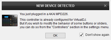

A detection window will appear next, verifying that the device is properly connected.
Click to OK.
The unit is now ready to operate.
