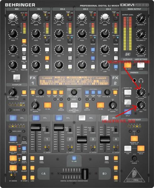

The allowed functions available for MIDI shortcuts are:
1) headphone_crossfader
2) headphone_mix
3) headphone_volume
For the time being you don't care about the first one so you need to link the second and the third one.
The headphone_mix allows you to switch between preview channel (on the left) and master channel (on the right); if this function/knob is on the middle you can hear both preview channel and master channel together.
Headphone_volume allows you to set the volume of your headphones.
I suggest you to link both of these 2 functions and try yourself by your mixer like in the next picture (remember that not to owning this product, I don't know whether these two knobs are mappable or not):
By the way, don't forget to push the PFL button on your mixer of the channels which you want to cue!!!

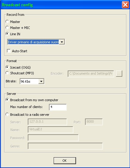

If you mean for broadcasting you need to set up the mic in yours pcs control panel. Select sounds and audio devices, on both audio and voice you need to select the DDM, or usb device, and then test hardware. Once that is done reboot, then test again. If its all good then open VDJ and in the record config select master and mic. Then you should be able to broadcast the mic output.

As TearEmUp has written to you, for broadcasting you can plug the Master channel of your mixer in to LINE IN of your pc:
