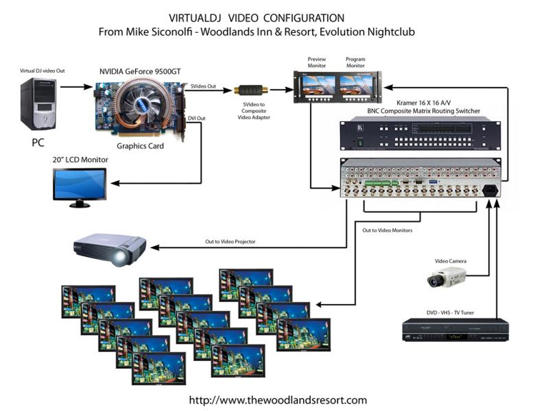

Here is a standard video configuration I've put together that works well in my club.
Click for larger view:
http://www.virtualdj.com/image/91542/35589/video%20configuration.jpg
Posted Sat 26 Jun 10 @ 1:08 pm
