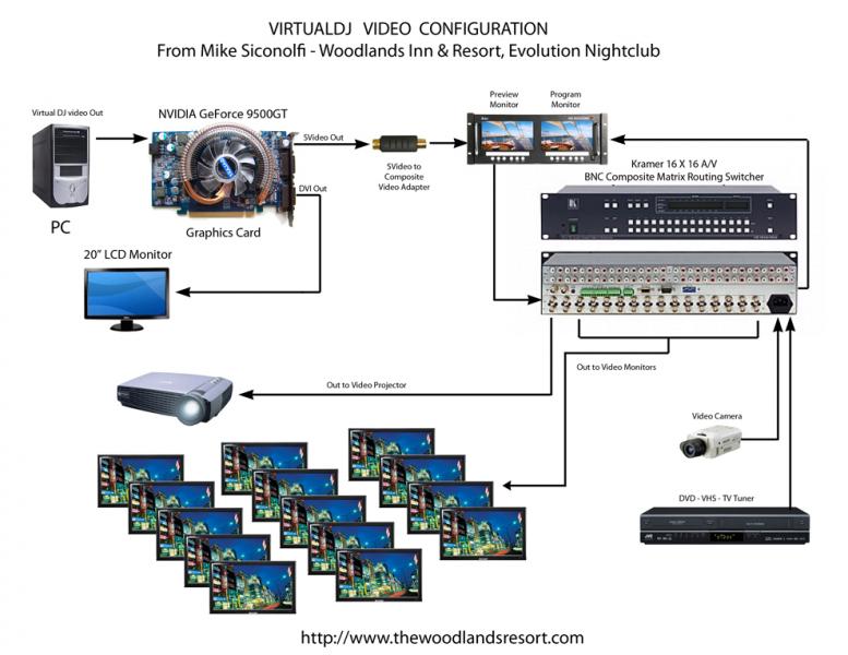

Here is a standard video configuration I've put together and is used in my club.
http://www.virtualdj.com/image/91542/35589/video%20configuration.jpg.

I think Chris got sorted on that one two and a half years back...

Godfather, although i do appreciate the advice, this is an old post.
As it happens though, this is more or less what i use nowadays anyway so i guess i'm doing something right!!!
Hehehe...(",)
