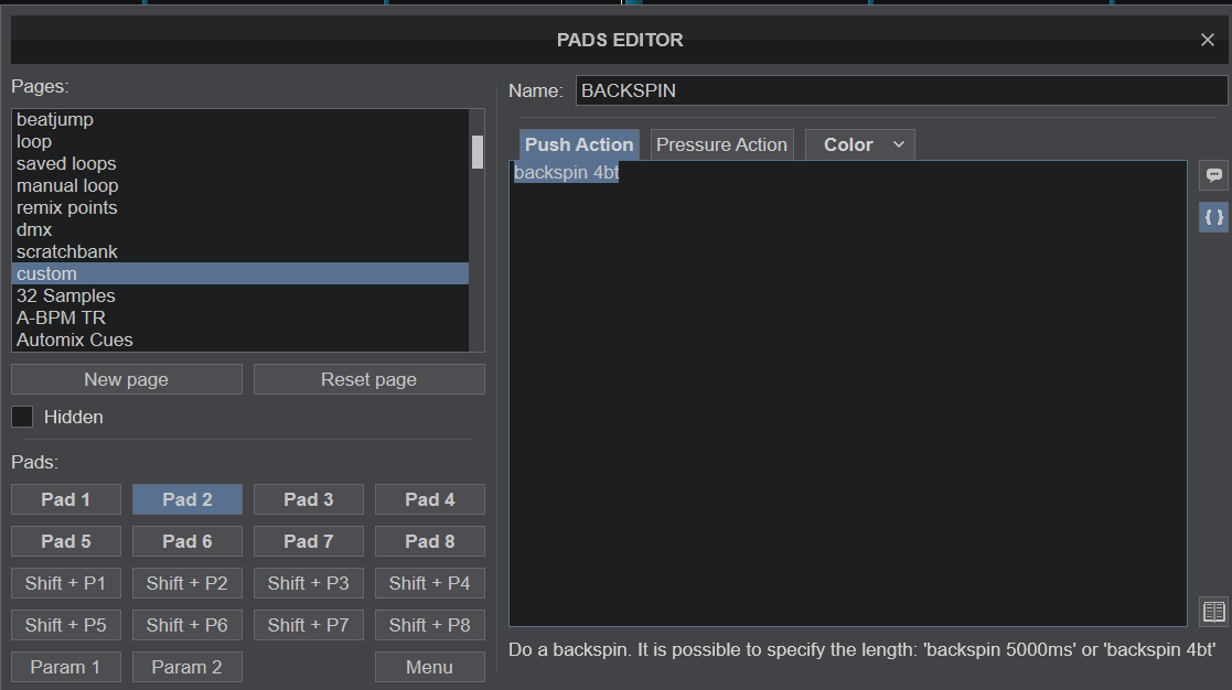

Hello,
I’m having an issue with the "backspin" effect. When I trigger it from the FX tab, it behaves abnormally, the music doesn’t stop after the effect ends. However, when I trigger the same effect using a custom pad I created, it works exactly as it should. The custom pad contains only the text: "backspin 4bt".
I’m not sure why this is happening or how to fix it; if anyone could offer some help, I’d appreciate it.

P.S. I forgot to record what the backspin script looks like for the custom pad, so I’ve included an image instead.

the backspin action and the backspin effect are not the same thing, check the effect gui for button states.

Now I get it, I have two options, beats that are setting 4 beats and strenght setting in 50%

I took a settings file that I had saved last year as a backup, deleted the current one, and pasted in the old one; the backspin issue persists. I think this rules out any configuration changes I might have made—though I don’t recall making any.
Could it be a bug in the program?
I have two laptops; it works normally on one, but not on the other. I checked the native_Backspin.ini file, and both have the exact same parameters.
The only thing I did to the laptop which backspin not work correctly was to install some pads. Could there be a conflict between one of these pads and the backspin function?

@locodog It worked, when my effects are full list I got the strange behavior, when set to legacy it works as I know, is this normal?
