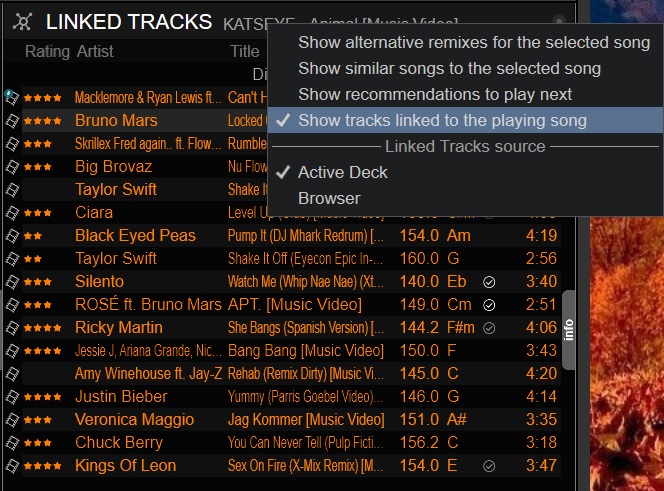

Maybe your linked setting on laptop isn't referencing active deck [check options dot on linked header]
Posted 2 hours ago
It is the same as this picture.
Posted 2 hours ago
it is exactly the same on both computers, now I will try to copy/paste my vdj program folder to laptop (not the licence) and see if this will help some how?
