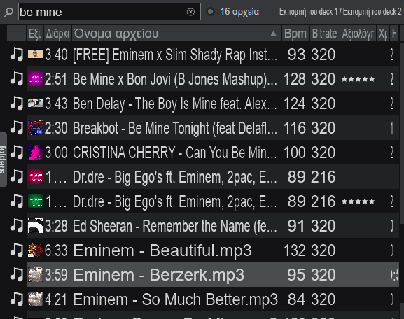

hello i have an issue i search be mine and random songs pop up like eminem berzerk i cannot fix it i changed search options to file name only and still random songs come up i also checked for possible tags that in the eminems song but nothing close to be mine and it happens with other searches aswell please if anyone knows the answer help me thank you

eminem berzerk
do you see why it's picking up?
Posted Sat 05 Sep 26 @ 6:11 pm
yeah but this doesnt make sense,a lot of songs can have these letters inside, can i make it somehow more strict?
Posted Sun 06 Sep 26 @ 6:10 pm
Well what exactly are you searching for? What is the full artist and title?
It's always better to search for something distinctive or unique rather than short words like 'be'.

Use double commas
"be mine"

The answer is simple
If your search query is too broad, you can use double quotes (") to make the query return exact matches.
The funny thing is that for most purposes you don't even need to close the quotes.
"be mine will return all tracks that contain exactly the string "be mine" in any of the available search fields.
No, you cannot override search temporarily, to search one particular field only.
However, since "searchFileds" is an option, you could create some custom button(s) to provide similar behavior if you think you need it that bad.
Open settings, and search for "searchFields" option.
Mark the number it shows. In my case it's 40895
Make a custom button like this:
setting 'searchFields' 40895 ? setting 'searchFields' 0 : setting 'searchFields' 40895

Something like %title% be mine would be fine I guess for a temporary override. You don't even need the equation mark (=) since the tag on front would provide the necessary logic.
