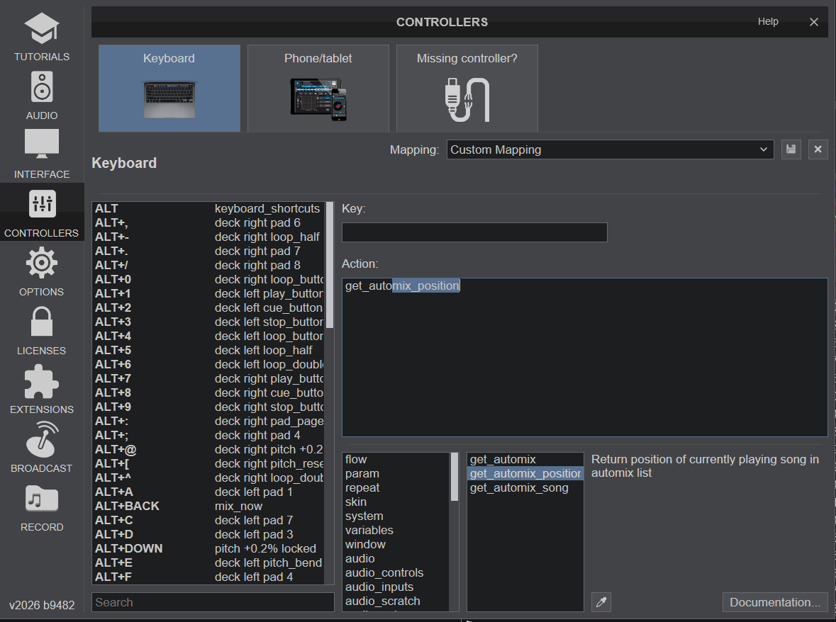

keyboard mapping holds onsongload
Posted Sat 25 Jul 26 @ 1:03 pm
