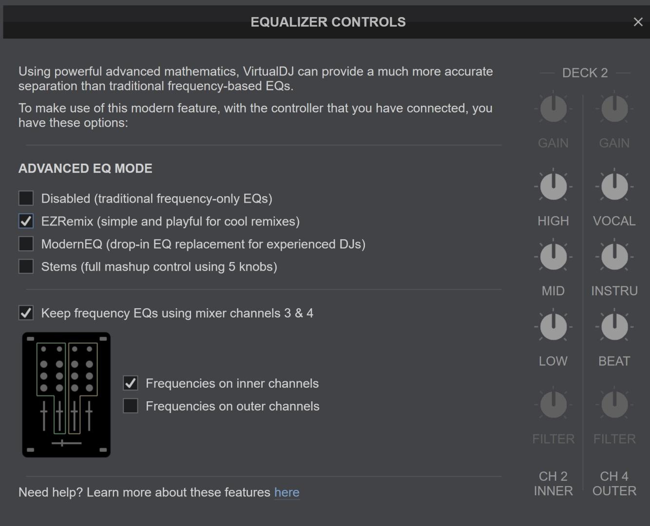

Not sure what I did. Either way in advanced EQ mode I set it to ezremix and then Enabled keep frequency EQs on inner channel. But the outer channel doesnt display the ezremix eq. It apply audio changes but it only shows what it does on the inner channel... it transforms into deck 3 channel whenever i adjust sliders on deck 3, but deck 3 channel doesny properly display the names of the ezremix EQ. It used to work back then but Ive tried a lot of things and now I wanna do this again but somehow it is broken now.
Posted Sat 11 Jul 26 @ 9:40 pm

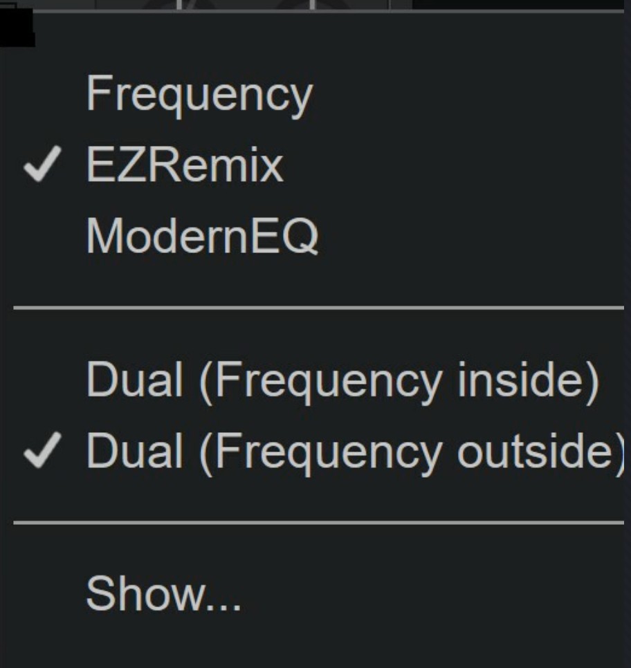

I can confirm that the Frequency and Stems are not working, as expected with EZRemix and ModernEQ when in Dual mode.
(only the Stems Full, 5 stem mode works as expected with the stems and Frequency EQs where they should be, and both apply EQs to the inner decks)

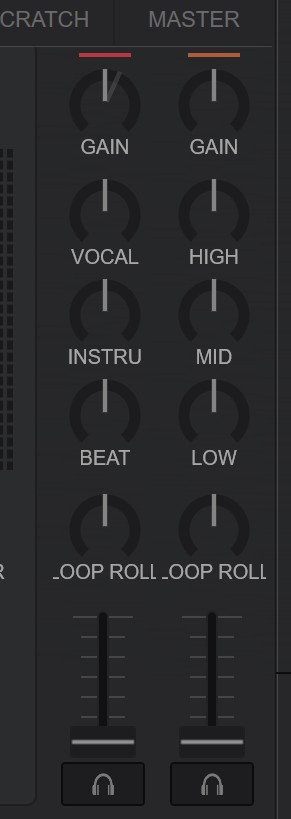

The EZRemix and ModernEQ both have the Frequency EQs reversed from the expected (and pictured in popup) location, AND the outter knobs are not affecting the inner deck as expected.
below is screenshot of Freq EQs configured to be on inner channels in setup:
(and pictured for deck 2)
and screenshot of skin (deck 2) showing Freq EQs actually on outter channels (REVERSED)
(also outter channels not operating on expected inner deck, deck 2)
(deck 2 loaded w track with stems 2, and same image if deck 4 is, loaded or not, w stems 2 track)
Setting eqModeDual = Outer
All 3 images are of same configuration, no changes.
Tested with default Pro skin
9482
Note: dont understand, just reporting, (in case it is helpful to the understanding)
that initially all 4 channels were displaying Stems when say "Freq on inner channels" was selected
AND
all 4 channels would toggle to displaying Freq EQs when "Freq on outter channels" check box was selected.
since this stopped happening don't remember which caused which.
AND again the Full Stems, (5 stem setup) worked as expected.

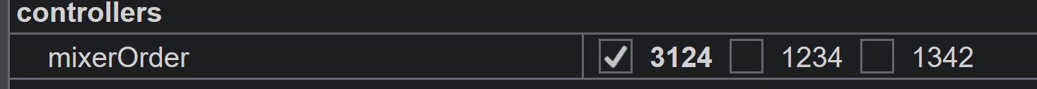

This works fine for me and my DDJ-FLX10.
What is the value of your setting mixerOrder?
How you see the EQs displayed will depend on that. The default (3124) will do what you expect, I suspect you have it set to 1342.
Posted Sun 12 Jul 26 @ 11:29 pm
I had the default one
Posted Mon 13 Jul 26 @ 2:32 am
It's still doing it. I dont know why. Mixer order is correct. It just decides to do some weird shit on the skin

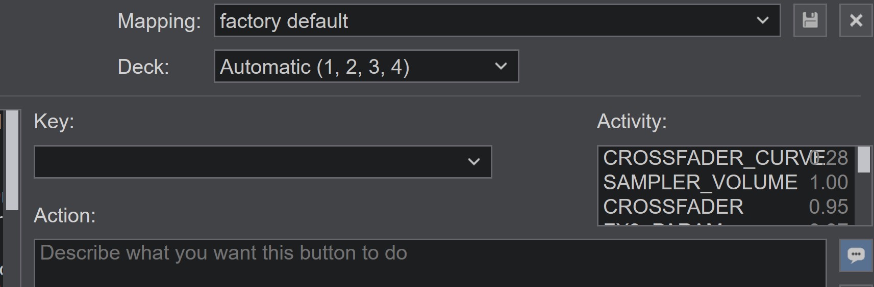

May not be the only issue, have you tested with the default controller mapping?
Appears that maybe the EQ_LOW mapping may have changed.
(the default mapping is: eq_low )
and in the controller's mapper, What is selected in the "Deck's" panel at the top?
My Denon MC7000 has "Automatic (1,2,3,4)"
with no option there to select say 3,1,2,4, which is the setting option, set as is yours.

What is your Deck's set to in the controller mapping ?
As it could be controller specific in my case.

DJ VinylTouch wrote :
Not sure I understand the question. I'm using the factory default mapping for the DDJ-FLX10, which also seems to be what OP is using, except it looks like OP's using Windows.
Referring to the Decks displayed, in the Controllers Mapping window:
I am unable to change to say a 3, 1, 2, 4 deck order to match the
setting: mixerOrder
wondered if this was maybe a part of the issue.

It doesn't matter if the MIXER ORDER is 3124 or 1234
The deck assignment on mappers tab should always be 1,2,3,4
Then you can use the MIXER ORDER setting to change the mixer if you like.
But (I repeat) the mixer order is irrelevant to deck assignment on controllers tab..
