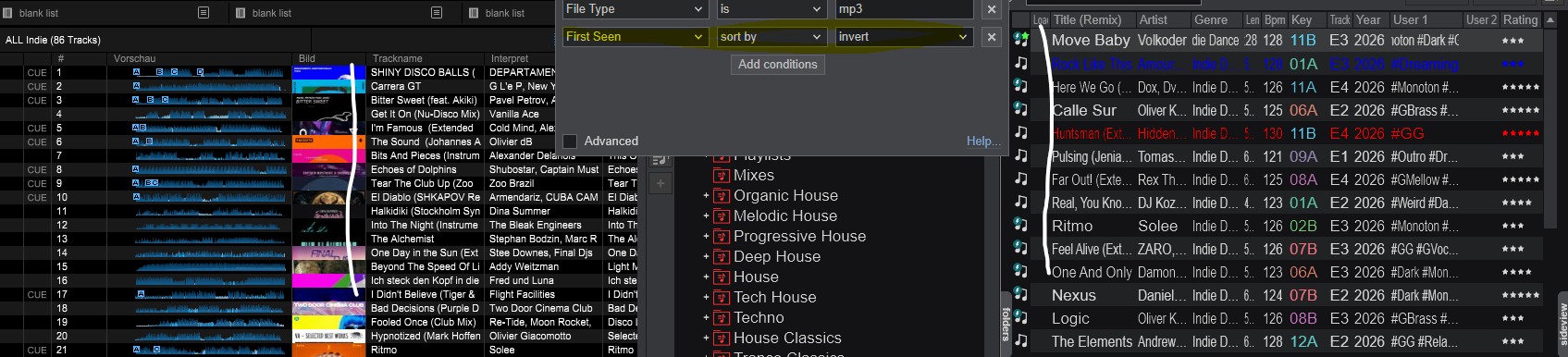

I have a different issue with the CDJ Export and I think, but am not sure, this worked in the past:
I export a Filter-Folder containing a sorting criteria. When inspecting the stick and the exported playlist in Rekordbox the sorting of the songs is all over the place. I can not even tell what sorting criteria is in place.
Here is a screenshot. On the left Rekordbox, showing the result of the export. On the right the source with the sorting criteria.
Cheers Jochen
PS: I'm using version b9583 on Windows.
