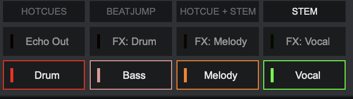

a bit restrictive on the order, might get a bit tired after a while.
padpage like shown in the pic, I'd reinstate effect_stems bass, get rid of the echo out button then make padshift 1-4 each effect_stem on & have a echo out call with conditions,
slight duplication of buttons but keeps it simple when you might have had a beer or 3.
Most of these 'global' features in other SW mostly boil down to a script somebody else wrote for you, nothing actually new in result, just a smarter way to do things.
That said stem driven ducking echo would be a nice effect, I asked for that back in Jan this year, suggested too late for the fx revamp of 2026 :(
